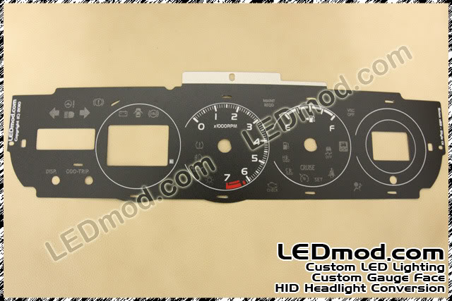

Hey so browsing through the site for the last 2hrs, trying to find this thread about changing the backlights in the dash, i just bought a 2011 xB on tuesday and im trying to fix it up so if any help that would be awesome!
Old Dec 6, 2010 | 10:42 PM
  #85
LEDmod's Avatar
Posts: 2,093
From: Anaheim, CA & Las Vegas
It requires surface mount soldering..
There is small LED inside of the gauge cluster circuit board that you need to swap them out..
Also you need new gauge face that allow different color LED to light up properly.
stock gauge face has orange pigment that prevents other colors to pass through..
I have the custom gauge face for 2011
