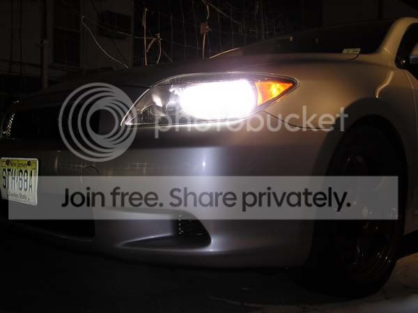

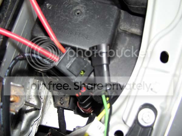

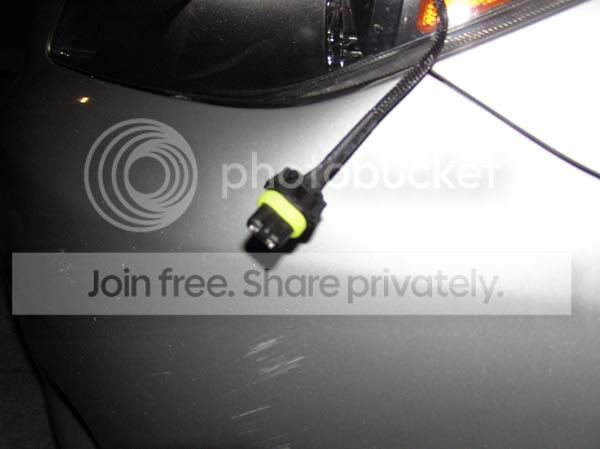

quick question.
i have two connectors in the 9600 hid that are not connect to anything.
are they suppose to be like that?

I am confused. Do you have a wire harness?
Because that plug with the 2 red wires I have never seen.
With the Digital ballasts it goes OEM Head light plug> HID Ballasts> HID Bulb.
And the connection from OEM Headlight plug to HiD Ballasts requires electrical tape or heat shrink tubing to keep it together.

I believe the above is an analog ballast setup...and that red wire you see is the Fuse. the digital ballasts do not have this.

it came with relay.
after i connect the realy to the battery, ballast, and one of the OEM headlight plug.
Then i connect the ballast to the light bulb.
But i got 2 connectors form the bulb with nothing to plug to.
Am i doing something wrong??
but it turns on.
Old Mar 11, 2009 | 03:51 AM

Yeah, (Well I think since I am not running a wire harness) The wire harness overrides the headlight plugs. The point is that you don't pull the power from your OEM wire harness which isn't made for that load.
So instead you are pulling it through your wire harness. So One of your your OEM headlight plug should be left there unused.
(Also look at step 4 with the "*" on it http://www.mobilehid.com/support.htm)
I says on headlight plug turns on the HIDs.
If they turn on and from what I see you did it right. Enjoy.
I hope some one here with this set up can help you more.

gammaTNT - those extra 9006 style plugs were left in with the kit so you can use them to extend the length of the harness to reach your ballasts or do a direct connection (which is what our farming customers do). just use the harness and you can remove those extra 9006 plugs if they get in the way.
