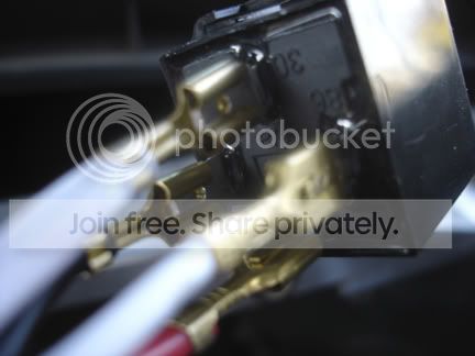

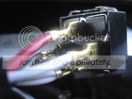

Yeah it was prewired... but how is it possible that it isn't working...thats what i didnt get in the beginning when i hooked this up...
Now for the first photo, and you noticed, I removed the black thing to move the wires around... Here we see...:
The Original Set Up: Power/Red-30, DoubleWhitePositive Wires (HID)-87, Ground/Black-85, SingleWhiteWire (Headlight DriverSide)-86.
Nothing Fired up...
Here is setup number2:
This new setup with the Power and the DoubleWhiteCable inverted...
NO lights...
But Like I stated, Red Cable + DoubleWhiteCable =... HOLY LIGHTS lol...[/img]

Whats even weirder is... I can light my halogens, but I can't activate the relay... *rubs chin*... I also previously had a 3rd party lenshousing that used a similar hook-up device to go to the light terminal...that lit up... but... this wire from the driver's side headlight is really irritating me...
I know I know... 99% of you had plug and play LOL....

Hello bBsactoguy,
I am reading about all your problems while Cliff is Out of Town. I too was initially confuse with his kit because his
Original Instructions are Generic and applies to other automobiles.
Any case, don't take this personal, I'm just trying to offer you a little help with your pred1cament.
1. You with all due respect are making a Huge Error if you are going with that Above Link about McCulloch HIDS.
You don't have Mulloch HIDS and NONE of that information applies to your situation. Take that link and put it in the shredder!
According to Cliff, McCulloch does not or did not supply a relay harness therefore they want Customers to make their own! How stupid is that?
Here is what Cliff says about McCulloch,
Drop all the way down to HID Kit Wiring Harness:
https://www.scionlife.com/forums/vie...sc&&start=1420
2. Below his comments about McCulloch is a pic of the Relay Harness that came with the kit.
Yes or No? Do you have that Harness?
Make sure if you do that everything is put together like that pic. Any Relays, wires, terminals that you bought using that McCulloch Link you went to should Be Tossed. You ARE NOT to add or replace Relays, wires on your own. You don't have to! I am cognizant that possibly you might have a defective relay or harness but, that is not likely or yet to be determined.
I THINK you might be grasping and could be miswiring and getting deep & lost.
So, if you can put EVERYTHING like the way it was BEFORE you took the Relay and wires apart.
3. Now go to this link and follow the pics and Instructions that Cliff Advise me to follow when I was originally confused:
Hope this helps,
MR LUV
The LUV MOBILE is being Constructed and modded
