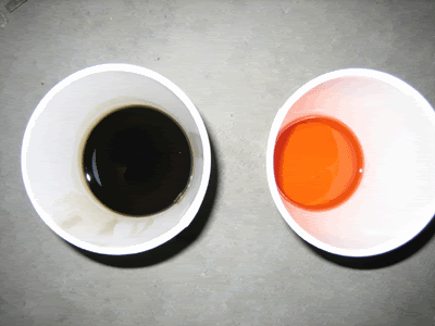

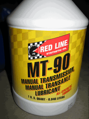

Thanks guys...reading this post helped me with changing my MTF fluid. I just hit 32K miles, and this was on my list of items to work on. I too went with Redline MT-90. I purchased this stuff from Autobacs, for roughly $10/ Quart. My 2005 manual states 2 quarts are needed, so a little over $20 should be the damage. Since it is a little difficult to explain what the drain and fill bolts look like, I took the liberty of taking pictures. This was well worth the time, money and effort. I can't remember my xB shifting so well. In addition, I was experiencing issues with my tranny popping out of reverse. This issue seems to have been resolved
The goods: 2 Quarts of Redline MT-90, a funnel that is long and can bend, a 24mm wrench, and something to drain the fluid in (not pictured)

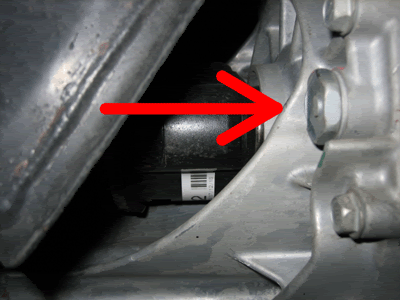

Location of drain: If laying on your back, looking up under the car, with your feet towards the front of the xB, and your head towards the rear, look for this big 24 mm bolt that is facing the front left wheel on the tranny:

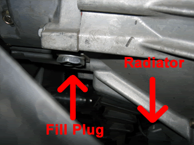

Location of fill: In the same position, but closer to the front of the vehicle, this 24 mm bolt is facing the front of the radiator.
The difference in the MTF: Here is a picture of what the Manual Transmission Fluid with 32,000 miles looks like, compared to brand spankin' new MT-90.

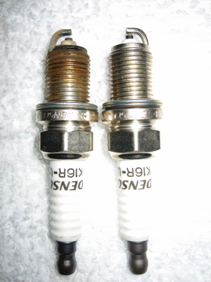

Since I was already working on the car, I also changed my oil, and replaced my spark plugs with OEM Densos. Here is a picture of the difference between the old and new plugs.
