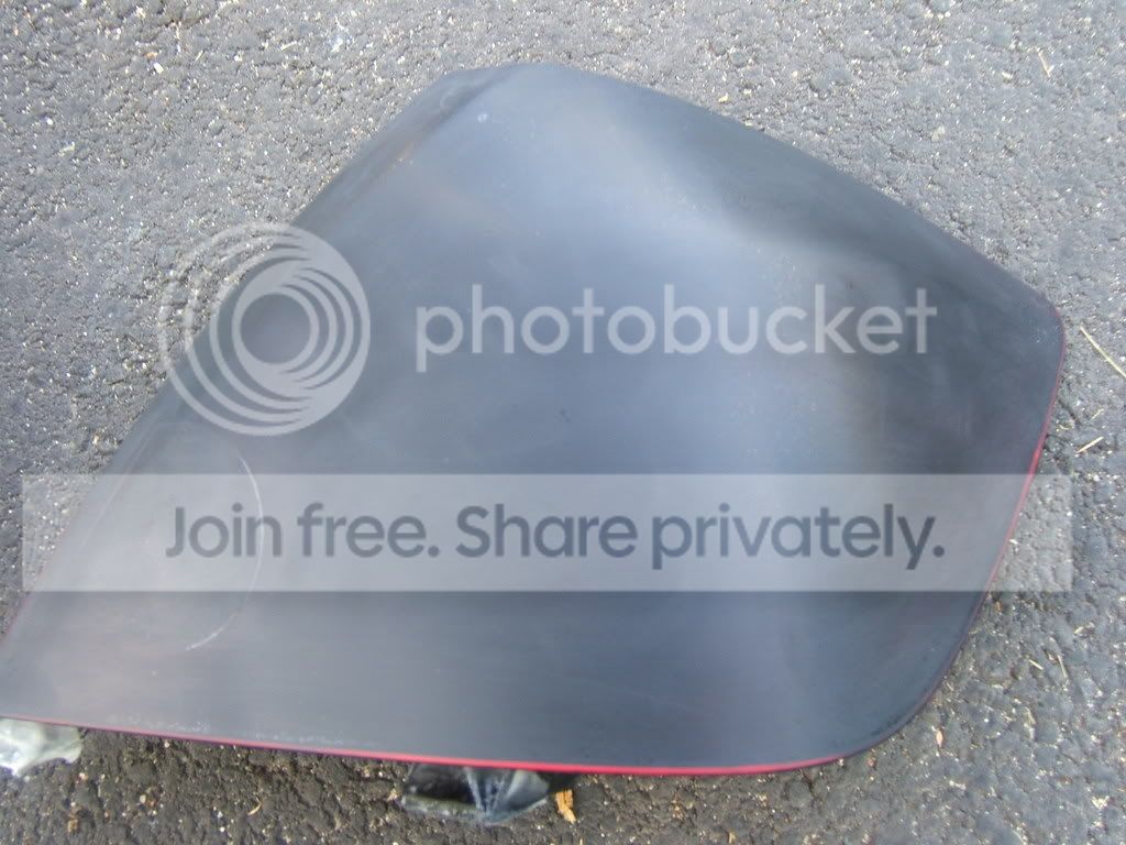

wait wait u say the shine is on the headlight, that pic looks like it just has vht on it without clear, and it looks pretty normal, could u try to get some more pics

That's the finished product....I haven't taken the pic with the streak yet. It won't stop raining here lol. I have 2 light coats of clear and 2 heavy coats on it, just not sanded and shined. I'll get the pics up after I get home from work (about 4pm CT)

it should still be very shiny with the clear on, check my diy for the clearing and sanding and buffing. u need a lot lot lot lot of clear

do this with them
wetsand with 1500 grit until they are smooth and look lie this with no orange peel
[imghttp://i215.photobucket.com/albums/cc48/jakewatson/047.jpg[/img]
then load the clear coat on until they are glossy. what clear are u using anyways?heres what they look like after all clearing. do about 4 or 5 pretty heavy coats
no wet sand the clear with 1500 or 2k if u have it until its smooth again
now buff them out with a rubbing compound, then plasticX then a wax. my diy is in my sig it as all pictures and detailed steps
