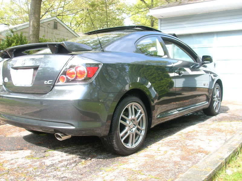

well ive been looking through the posts and found alot of help on this but i just need some things clearified. in order to remove my tailights i gotta remove the bumper too? for the emblems, what can i use to re attach it to my car after taking it off to paint? Name:  DSCI0637.jpg

no you wont have to remove the rear bumper. All you have to do is remove the outside bolt to the bumper in the wheel well. You gain access to the outside bolt to the tail light that way. You can probably use 3m tape to reapply the emblems.

If you are careful enough when removing the emblems, you can probably re-use the adhesive that's on them already. Otherwise, do like Zendog said and get some 3M double sided tape.
