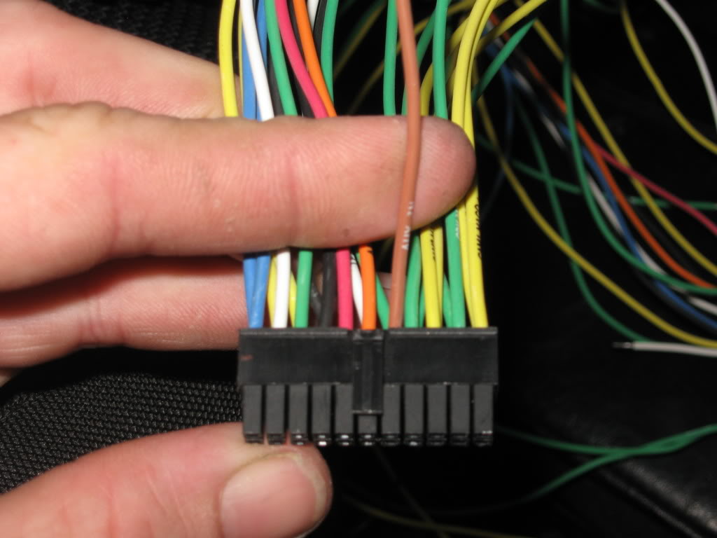

Old May 12, 2011 | 09:07 AM
  #300
crush02342002's Avatar
Posts: 11,271
here is a pic that kinda explains it...
take this wire
and connect it to 0-5v output from gauge
some pnp harness do not have this wire in this connector so youll have to either pull a wire and pin from a universal harness (hard to do and sometimes both tiny tabs break off and you have to try it again). or you can order up some pins and crimp your own wire to slip into the correct hole.
if im not mistaken the pic shows you pin 18 of the 22pin connector. this is the location for aux gauge (wideband)
however the fic still needs to be calibrated to the wideband...ill have to do a write up on all this.
