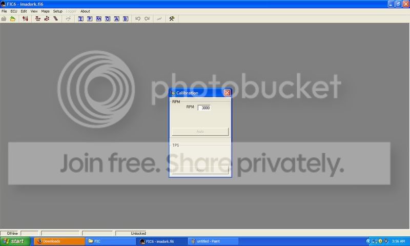

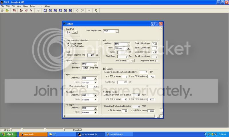

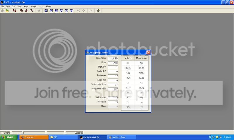

Old Jan 25, 2009 | 08:14 AM
  #95
Crayola_G's Avatar
Posts: 916
From: Miami, FL
check it out here's what i got under setup: system/aux/n calibration
i dont have anything hooked up to aux for the aem.
Old Jan 25, 2009 | 08:39 AM
  #96
Crayola_G's Avatar
Posts: 916
From: Miami, FL
oh & these setup options are from after i load ur map (imadork haha) up on the computer not my map

Old Jan 25, 2009 | 11:16 AM
  #98
crush02342002's Avatar
Posts: 11,271
oh btw the setup looks good, i wasnt sure if the setup would carry with the cal or what. so your setup is the same as mine.
