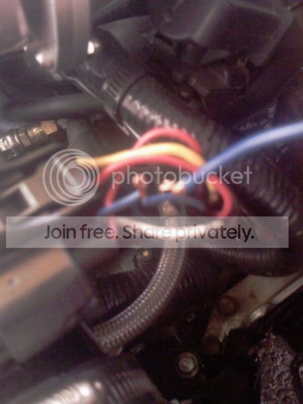

hey guys i need help wiring the air intake temp sensor, i tapped one wire to the blue wire on the maf sensor harness and the other i grounded to one bolt of the valve cover, i turned it on and it didnt work..
Are you sure its properly tapped?
Just asking, because i've made a similar mistake on other occasions.
I have mine grounded to the cylinder head btw. Not sure if that makes a difference.
Once your in the hydra, whats the value it reads for the AIT??

im gonna try looking for another ground but yeah it reads 13F on a 100 weather, i didnt solder or crimp it completely coz im not sure if it works but it has some very good contact

here i found the maf wiring diagram, its the blue wire
http://scionlife.org/Scion_Docs/2005...%20control.pdf
no i need to find out why its not reading right

Are you sure it has to be conected to engine ground and not sensor ground?
Pito

im a noob and im kinda lost of what you said, but sensor ground you mean i tap it to the ground wire of the harness? i just checked the diagram again and i found the grounding points, im gonna put it there..

Wire one wire of the IAT sensor to the blue wire on the MAF and the other wire to sensor ground; not engine ground.
In fact you can use the sensor ground also available in the MAF conector. It is one of the red wires (pin 5 on the MAF connector).

^^ i'll look into that.. there's two red wires though.. not sure which is pin 5, heres a pic
i ground it to the red wire on the left most?

The red wire that sits in one end of the connector
1-Yellow
2-White
3-Red
4-Blue---->IAT
5-Red---->Sensor Ground
Pito

Side note.
You do know that the blue wire for the IAT requires you to cut the stock wire and tape up/not use the part of it going to the MAF; right ?
I mention that just in case!
