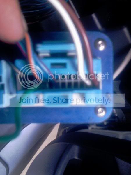

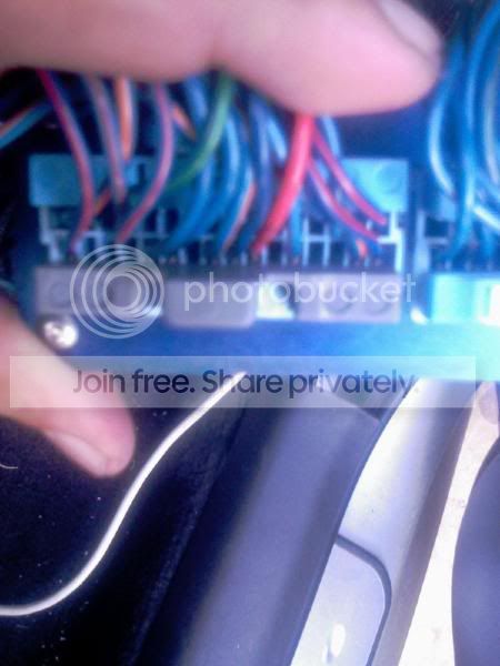

here's the pic i took on the ems harness
A wire (brown) to B1pin (grey harness)
B wire (white) to B2 pin (grey harness)
C wire (green) to B9 pin (grey harness)
D wire (black) to A11 pin (grey harness)
E wire (red) to D7 pin (big blue harness)
Old Oct 7, 2008 | 07:58 PM
  #344
Guru's Avatar
Posts: 637
From: Novi, MI
They look right. You make sure the pins are counted from the correct side? Seems odd that it is not working. What is the sensor reading when key on engine off?

I just emailed andrew right now, i might send him my box and have him look at it, he said it could be my wiring circuit isnt working or my o2 sensor is bad.. the wiring im sure is correct, i counted it a lot of times.. you can even count with me from the pictures but yeah its disappointing to spend 400 bucks and cant get it to work..
