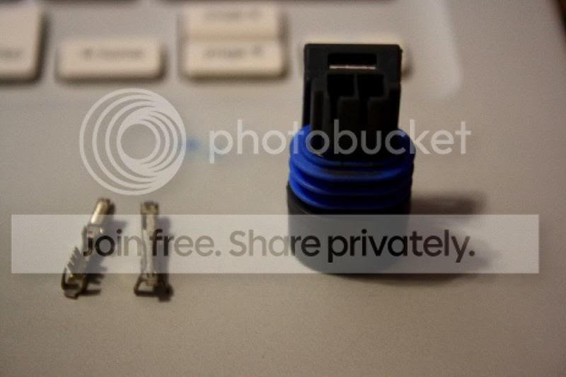

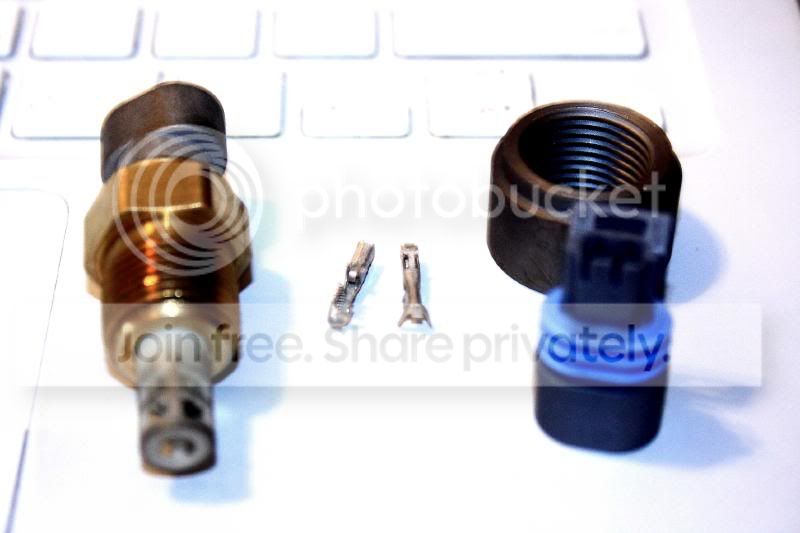

hey guys, i need help wiring my air intake sensor from hydra..
here's what I got
luckily the sensor fits my O2 sensor bung so no problem mounting it
i need help with this
as i see it, those two lil metal thingy is where i loop the wire and insert into that harness.. but which wires on the maf sensor will i tap? does it have a positive/negative polarity?
Old Sep 5, 2008 | 01:29 AM
  #283
ippskidder's Avatar
1UP Crew
Posts: 6,138
As far as I know, you don't have to worry about the polarity.
Old Sep 5, 2008 | 01:30 AM
  #284
ippskidder's Avatar
1UP Crew
Posts: 6,138
I grounded it to the side of the cylnder head.
Positive taps into the blue wire that goes into the maf sensor.
I just completely cut off mine ^^
Old Sep 5, 2008 | 01:44 AM
  #285
Ace83's Avatar
Ronin Scion
Posts: 11,117
From: TX
so it doesnt matter which side i hook the blue wire from the maf, which ever side i tap with the blue wire becomes the positive? thanks now im gonna look for an aluminum bung
