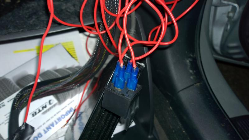

Here's how the #5 pin was connected to the relay wire, it did have tape on it though.

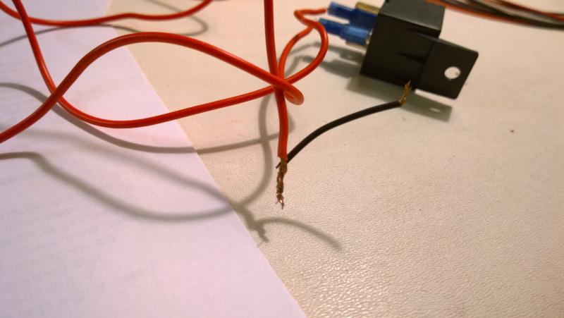

Also the #5 pin wire with a slight tug pulled out of the connector to the AEM. I cut the 22 pin AEM connector from the dezod plug and play adapter and spliced it all over to the 22 pin connector that came with the AEM and then just taped up the remaining unused wires. I had a relay connector so I nicely spliced that all in.

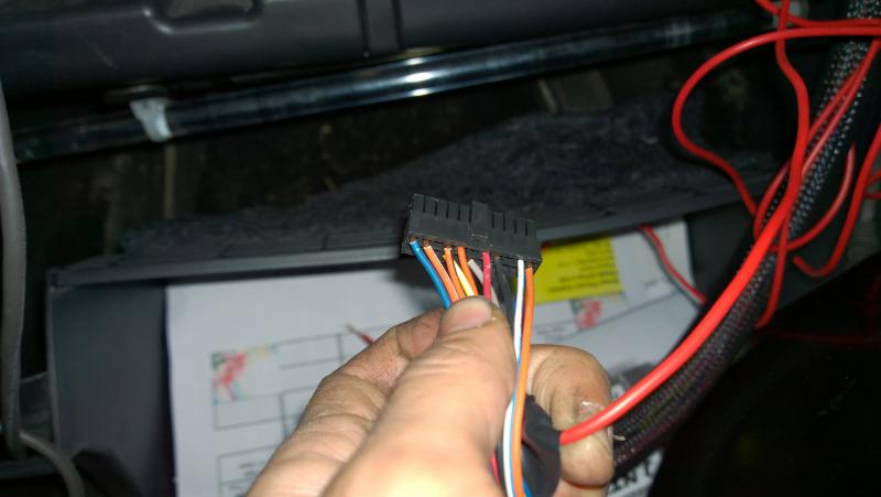

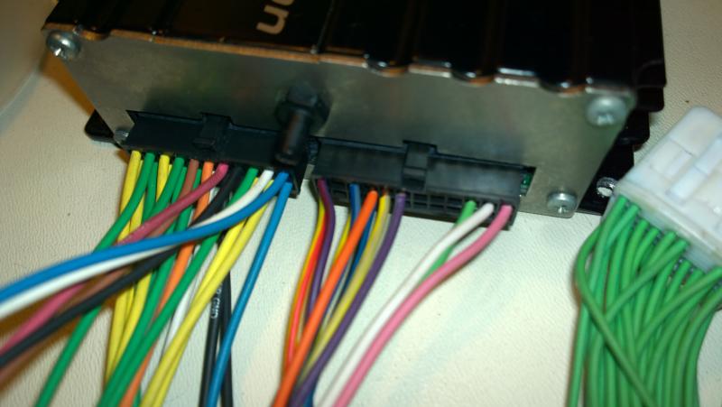

The remaining 24 pin connector has wires looking like they're about to come out of the pins as the copper is exposed, the picture doesn't show it as well as I'd like. I may end up splicing in the other AEM connector.
Anyway after fixing the wiring to the one connector and fixing the wiring to the relay I went and plugged it all in and the car still would not turn over. It was cranking, but I wasn't hearing popping or signs of even trying to start. I pulled two different plugs one at a time and tried connecting them to the coil pack while cranking to look for spark and I was getting no spark. Then I went ahead and completely took out the plug and play connector and connected the stock ECU. I still couldn't get it to start, and was still seeing no spark. I thought maybe a fuse blew, but the EFI, ECU-B, and OBDII fuses under the hood were all fine. I'm not sure where to go at this point. Any direction would be appreciated.

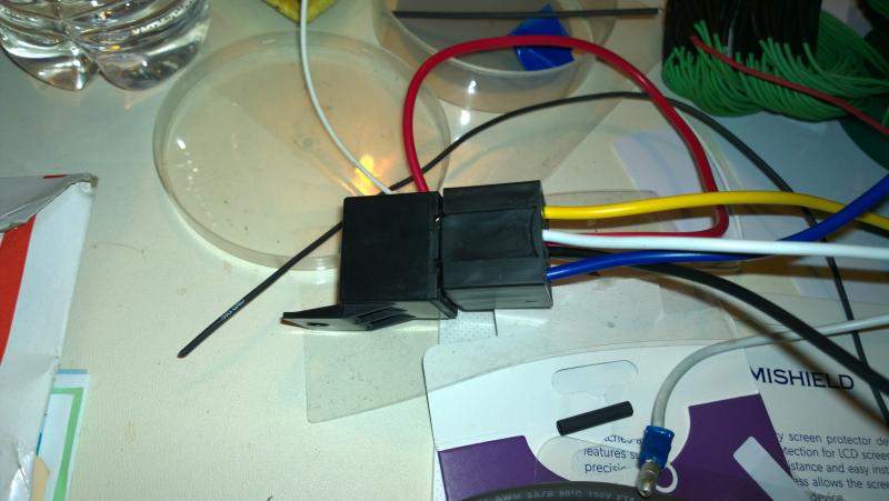

A quick question I had is does anyone know what the relay is for exactly, or at least how it's supposed to be wired? The way it's hooked up is pins 85 and 86 are powering the relay with the ignition on, but 87 and 30 are seeing power going through them only when cranking. I'm not quite sure why the relay is there when you could just connect pin 5 from the AEM directly to the other wire going into pin 87 on the relay. Unless someone originally hooked it up the wrong way. Usually I thought the point of the relay was to take the load off the switch and then power it from another source, but right now it just seems like I've just added in another switch that this current has to go through.
Edit: after some searching I came across some threads and figured out that the relay is to stop the power drain issue that the autos seem to have after shutoff. Apparently this ties into the speed sensor as well, so fixing that horrible wiring might be why I'm no longer seeing the speed sensor code. Actually I've seemed to get rid of the all the codes except for the downstream sensor showing up every once in a while. Not worried about that. Got a vacuum line run to the AEM, pulled the negative cable again, and the car seems to run very nice. Apparently the car is still stalling out on my brother, so I guess it's now time to mess with the AEM and try to log/see what's going on, but at this point it does sound like it needs a tune. I'm fairly certain that the previous owner is just running the dezod base tune? Which at least according to the instructions is a tune simply to get you running and driving halfway decent so you can then go get it tuned.
