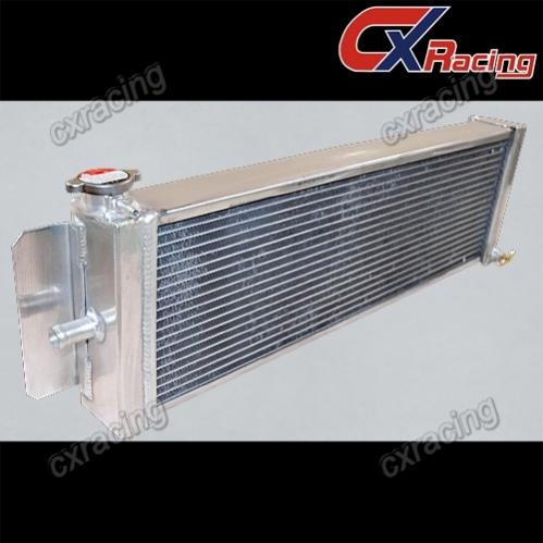

Sorry for the bad pic but the heat exchanger is mounted to the crash bar

Heres the parts before i put them on the car

Wow, that heat exchanger does look like an intercooler, I didn't think it would fill that much space. What does it hold 1, 2 gallons? That's odd that you would be running rich, since denser/colder air should lean out your mix, are you sure you don't have a leak. Is it going rich at WOT after gear change, because that would be your BOV. Good idea with the fan connected to the radiator fan, I was talking with SoccerBoy about a thermal switch. Do you have the fan wired to come on when the radiator fans switch on?

It holds about 3/4 of water. it probably is my bov and leaks some were I'm still twicking on it! All fans are hard wired to a switch pulled power 12v ingestion from fuse box yellow wire
