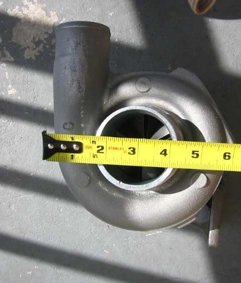

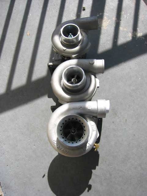

anyway, i planned to order a garrett GT3071R .82 a/r turbo from NurSpec, but then todd tells me that "it has to either have "a B cover, or a 2871 compressor cover" and that he isn't talking about the wheel in the turbine, but the actual compressor cover.
so me and geoff are confused, i keep being the middle man between him and todd. geoff is asking me questions like do i need a slip fit, or what the inlet/outlet sizes are etc, so this wasn't working because i keep asking todd the questions that geoff is asking, and all todd seems to care about is where geoff orders his turbo from, and i don't know why that matters, but it does.
i finally give up on playing middle man, and ask geoff to try and figure out what todd is talking about with this turbo (btw, geoff is the man with all this patience and service he has shown), and todd doesn't tell geoff what he needs to order, but tells him that he'll talk to his vender/distrubtor or whatever, and tell him what i need to order.
why todd can't just give me a part number through email, SL or text is beyond me, but the todd works in mysterious ways, so is there anybody out there with a simple kit and this kind of turbo can tell me what kind of turbo i need to order? i'm trying to wrap this turbo kit up and get it installed this month.
On t3/T4 hybrid turbochargers, there is typically 2 different compressor housings which you can use. One is a "B" cover, which is more compact and made for space confinement issues. The "E" cover is more widely used and is the default by choice for most companies. Their diameter measurements are different. The "E" cover is significantly larger than the "B" cover. Here is an old photo I took for someone showing the different between a "B", "E" and "S" cover.

luckily todd and geoff sent me confirmation that the details have been wrapped up and my turbo has even been coated to match the rest of the kit. sent geoff my payment, now i just gotta wait for tracking numbers and parts to arrive.
