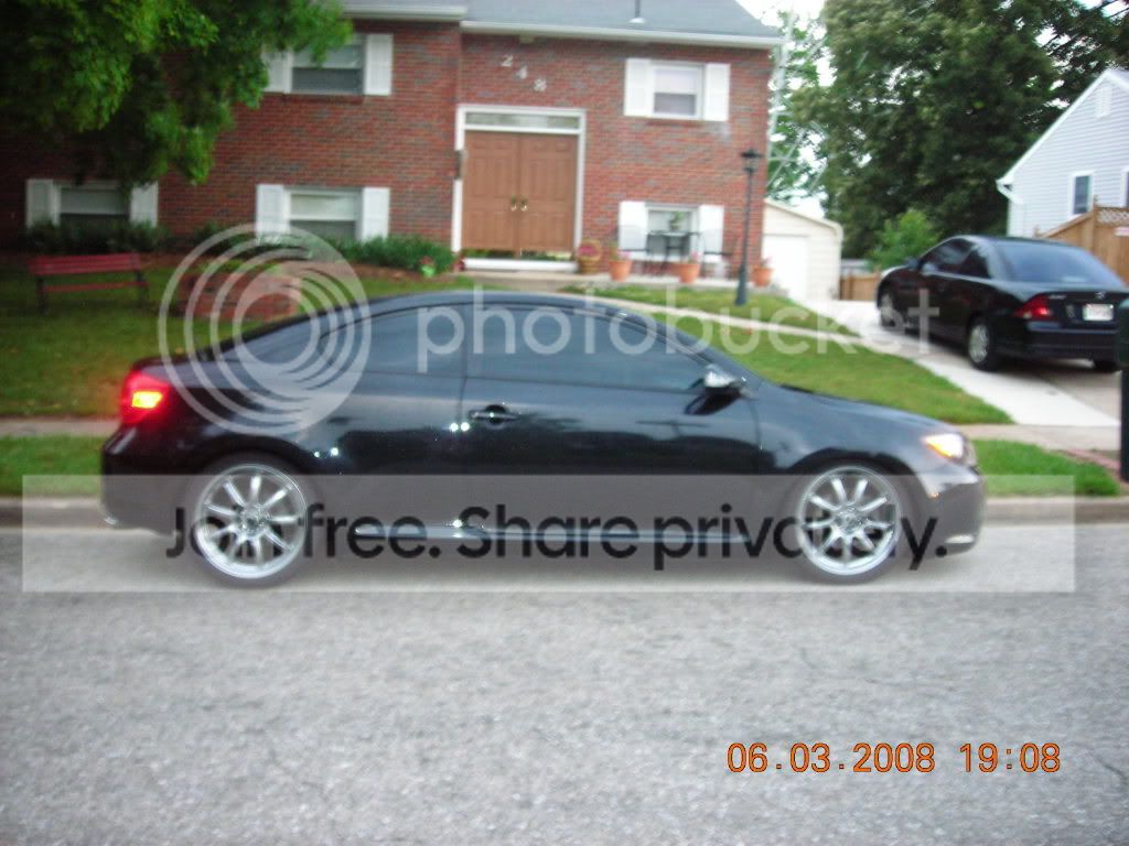

I had the same problem w/my Function and Form Coilovers, I took the rear struts apart and removed the two collars on the bottom of the thread, that gave me another .5" or so drop in the rear
Before:
After:
