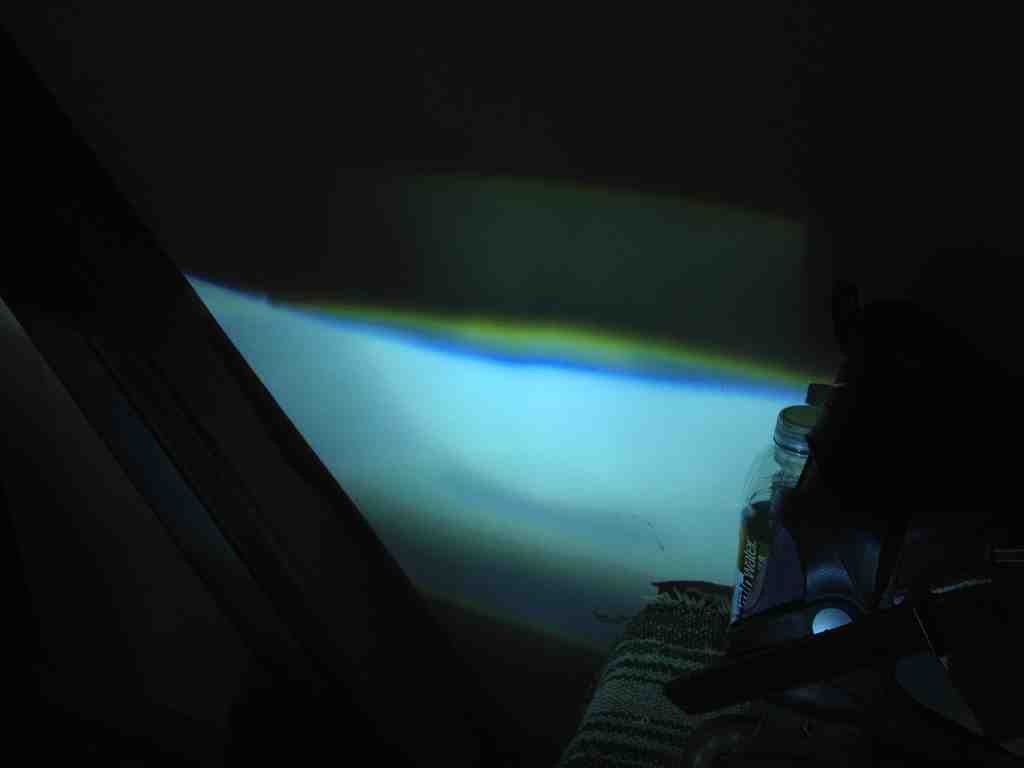

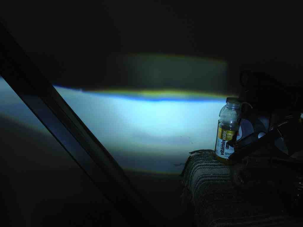

Originally Posted by duce95
Here is my purple 6000Attachment 10359Attachment 10360
this is my 8000k.
low beam:
high beam:
