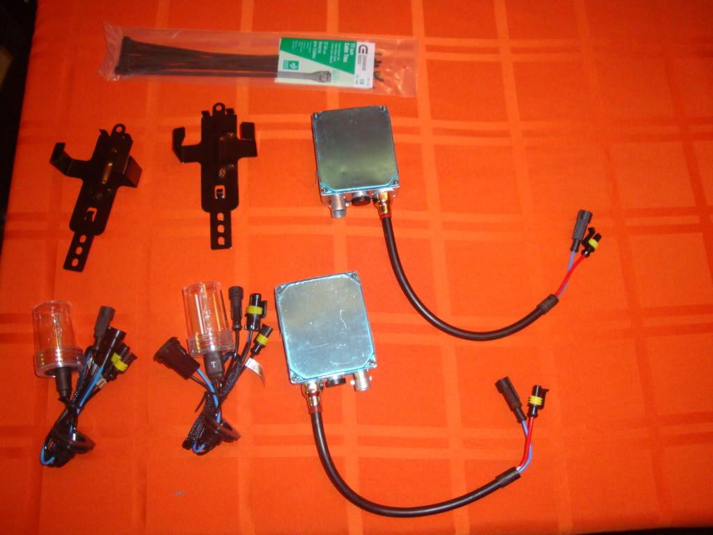

Hey Guys, heres my pictures of my placement and kit, i got the DDM Tuning 35W 6000k. They give no trouble so far, and i've only gotten complements from people who see me pull up so far, no complaints or flashes from other drivers. so i'm not going to cover my squierrel spotters.
The contents of my kit

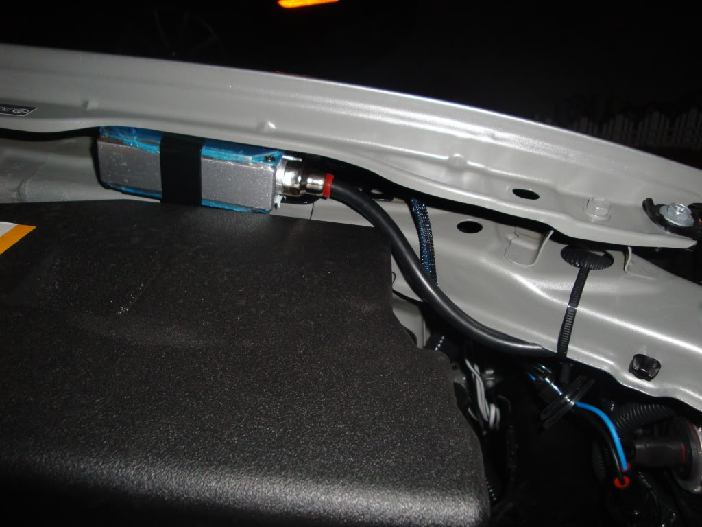

Passenger Ballast placement

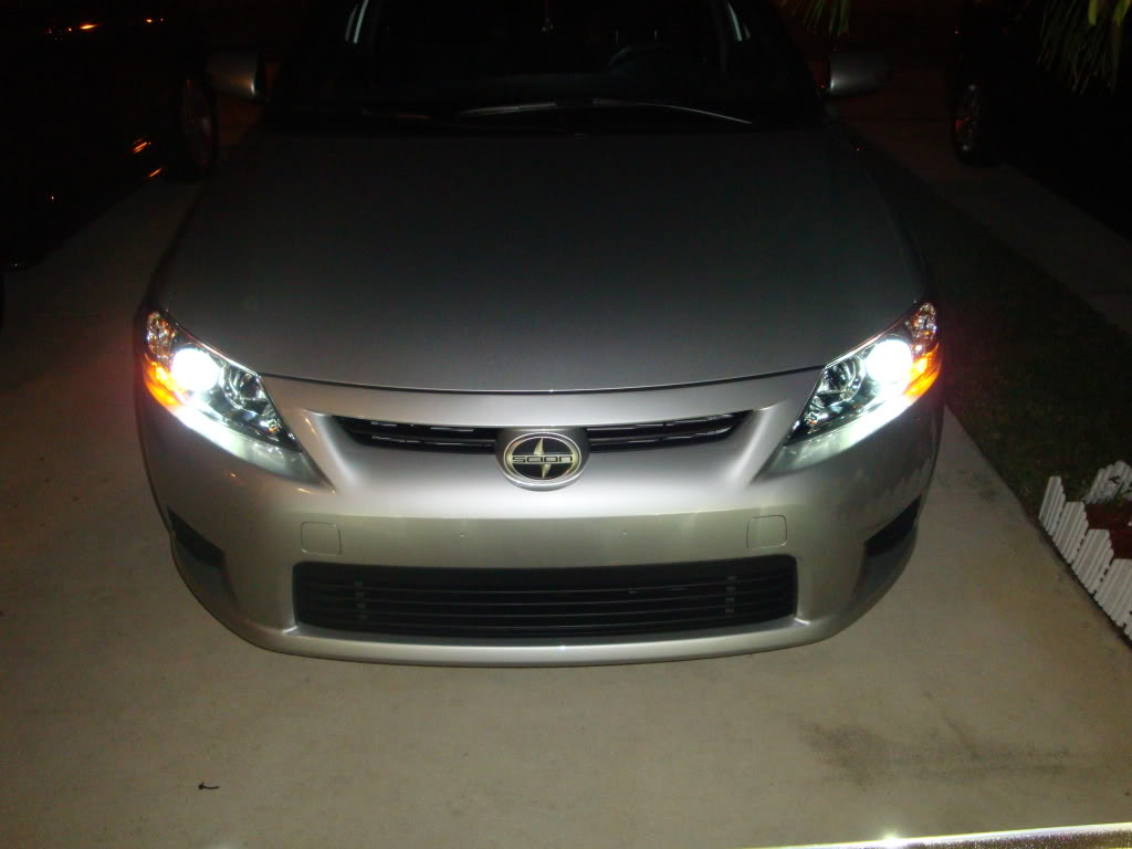

HID against wall (kinda)

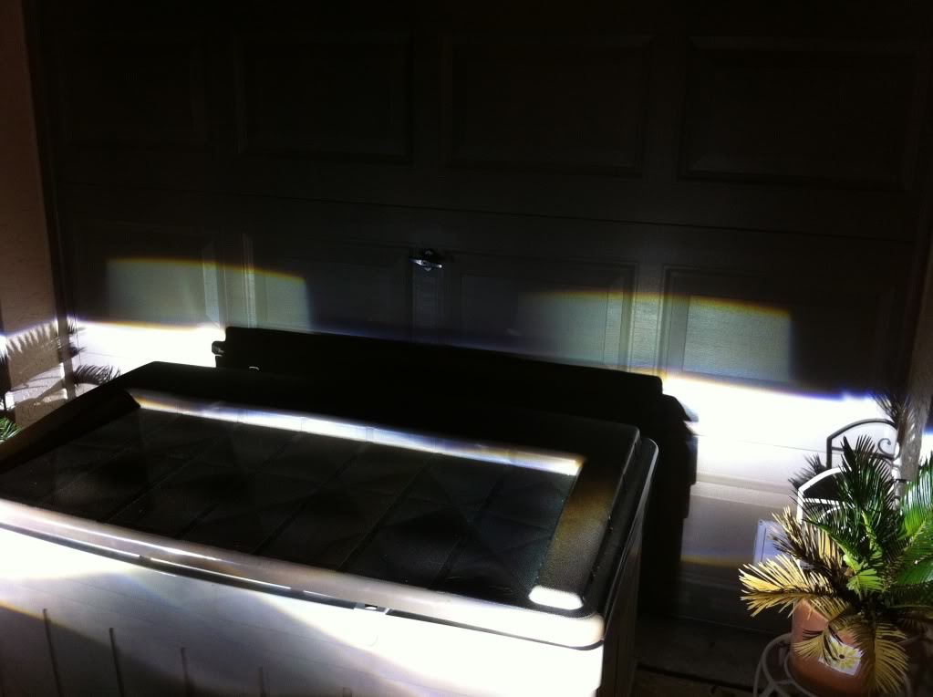

Head on of HIDs using a camera

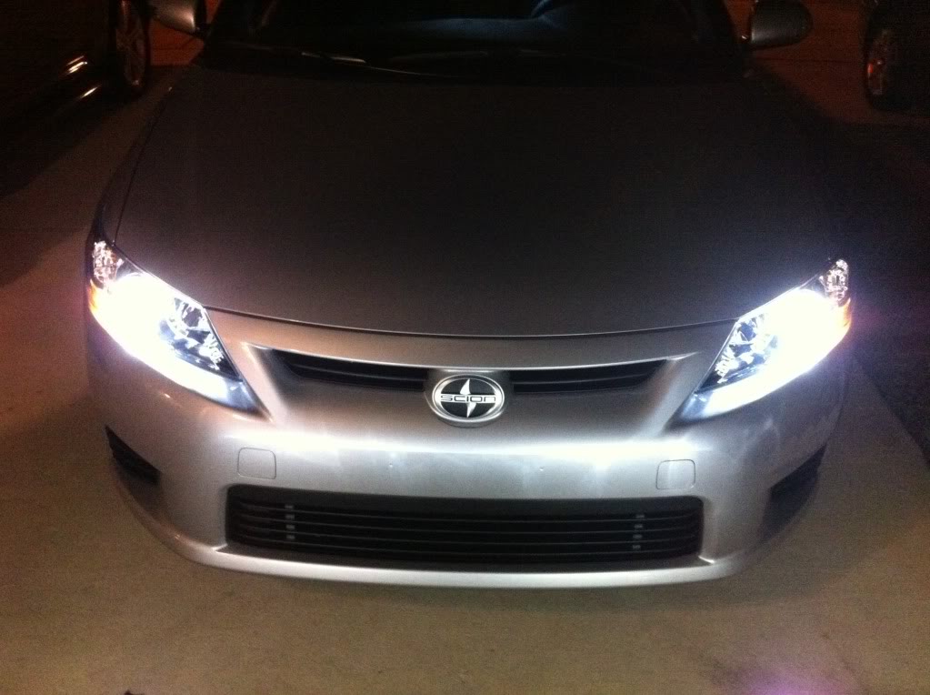

Head on of HIDs using my iPhone
The ballasts havent moved since i put them there, i've had em in for about 2 or 3 weeks now. They are inside of the brackets and then my dad and i slid them into the gap there, and then we wedged them down. They CAN come out, just gotta work em backwards. I wasnt sure if the spot is waterproof or not, but ive driven in some intense rain and no problems so far.
If anyones done this, and it actually does lead to problems, let me know please xD i dont want to have mine go bad because of fail placement
I eventually plan to move the ballast to the bumper though, and to tuck the wires more nicely.. but that wont be for a LONG time

Fantastic placement idea! Would I need those mounting brackets to achieve the same fit in that spot?
Also, you shouldn't need to worry about water. The kit is sealed very nicely at the connections.
Old Feb 20, 2011 | 02:47 AM
  #92
Enzie's Avatar
Joined: Jan 2011
Posts: 272
From: South Florida
I think it might fit without the bracket, but if you look at the close up of the passenger placement, theres a piece of the frame that comes up that the bracket kind of locks against. It helps keep it still, so i would definately reccomend the bracket... They are pretty cheap so i'd definately go for it. Plus it sorta makes the fitment tighter and feel more secure
Careful though, i scratched the bit of frame alittle while wedging it in, its little scratches that i dont care about anymore cause you can barely see them, but a scratch is a scratch, ya know? lol
