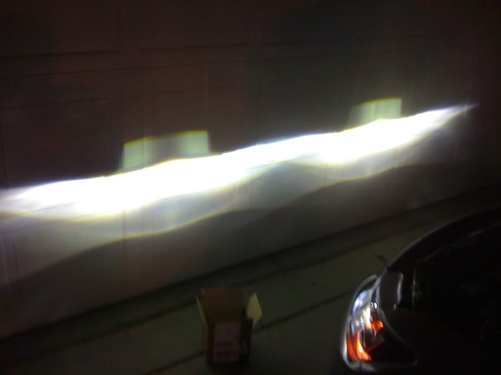

Here are pictures of my setup

Sorry for the crappy cell-phone pictures.

You need to take care of those squirrel finders so you're not blinding other drivers.

Originally Posted by biglilsteve
Huh?
The two boxes above the cutoff line.
Old Feb 4, 2011 | 07:28 PM
  #72
DustinMorrisTC's Avatar
Joined: Oct 2010
Posts: 104
How do you get rid of the squirrel finders?

Those boxes don't really seem to manifest in the cutoff while driving. Also they are there with the stock bulbs in place as well
https://www.scionlife.com/forums/sho...potter&page=13
bend the metal tab inside, i used a pen.
