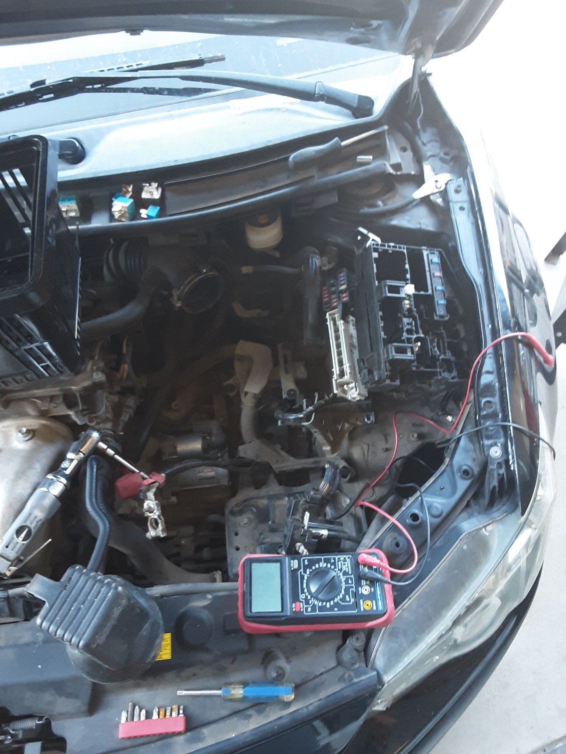

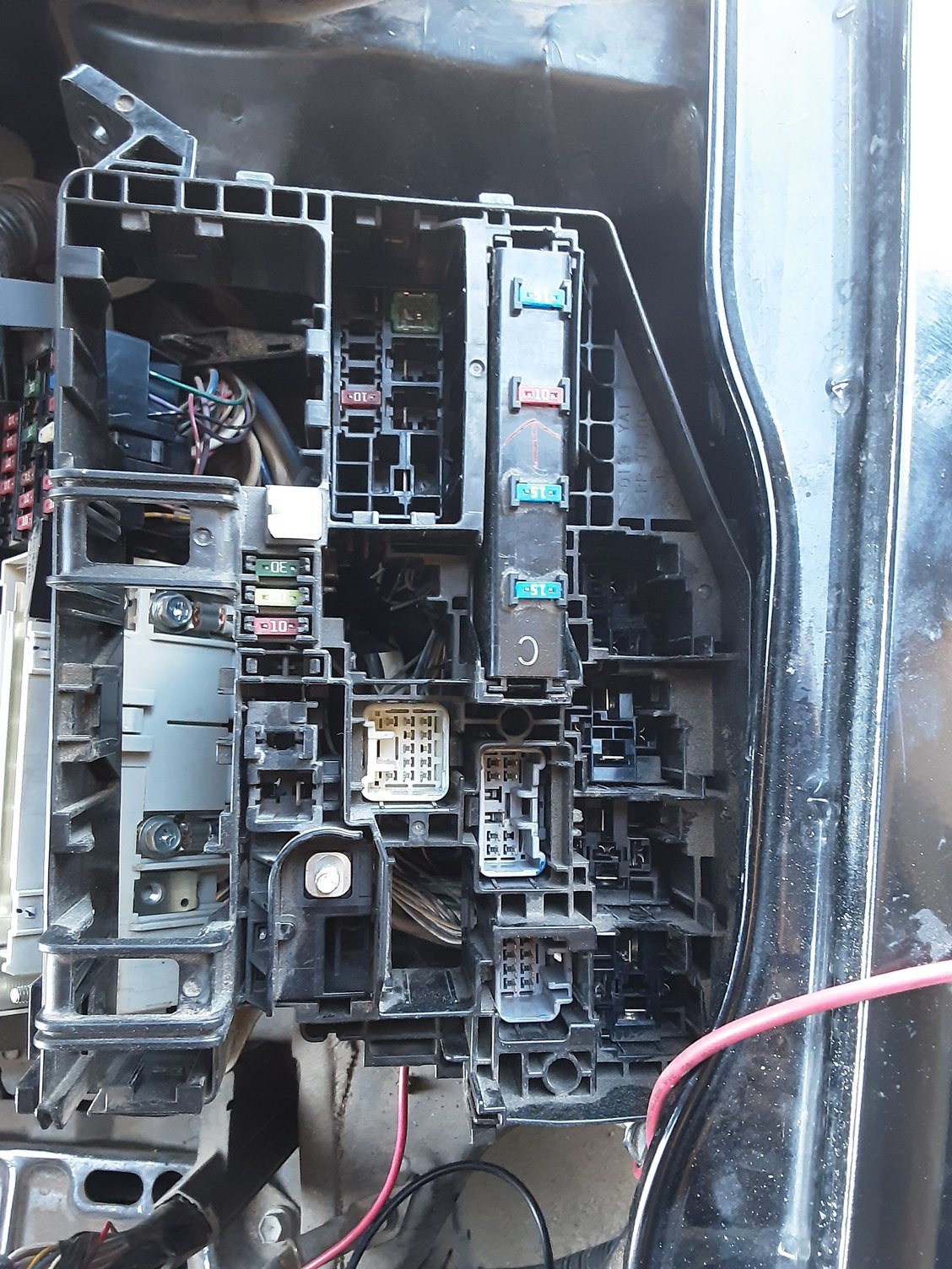

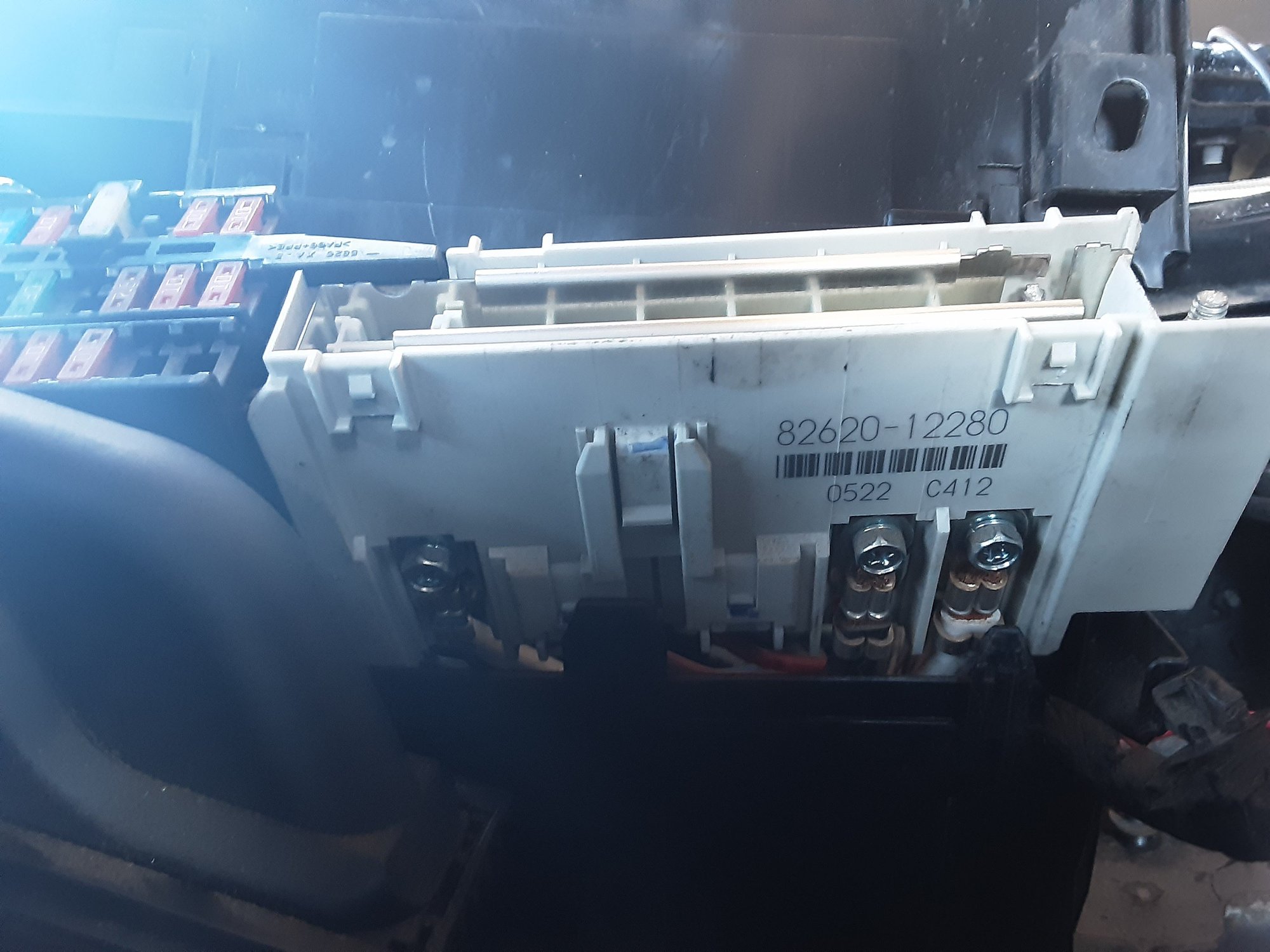

Well, after digging on the Internet, I concluded that it had to be my fusible link....What the he'll is that you ask? Well I'm not sure why it's needed but it's like a fuse box with no fuses. It's a chain of circuits that can blow. It's in the fuse box under the hood and you can't really tell it's no good until you pull it. unfortunately pulling it is not for the faint of heart. You basically have to disassemble your fuse box. The FL is not available at AutoZone or O' Reilly. I went straight to Toyota for the part. $40. You can also get it on Amazon. Here are some pictures.

Changed out the fusible link and it's starts up using the key. One thing I forgot to mention is that when it wouldn't start with they key, the blinkers didn't work either.
