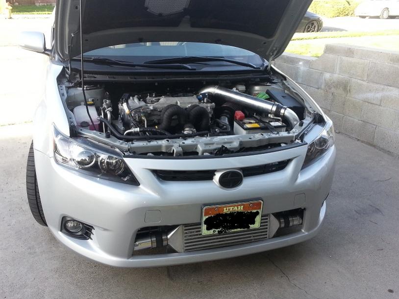

Sorry for the delayed response. Work owns my life. ha! I havent had time to make a video yet but here is the only pic ive taken so far. i will get more as soon as i can.

Looks good! Did you heat wrap the manifold?

Hey thanks Paul! you guys have an amazing kit I must say!
Yes we did heat wrap the manifold and downpipe. this was before i saw you mention in another thread that it can be hard on the welds. With that being said it may be coming off. although it does look really good IMO, i dont want to be ordering a new one anytime soon.
