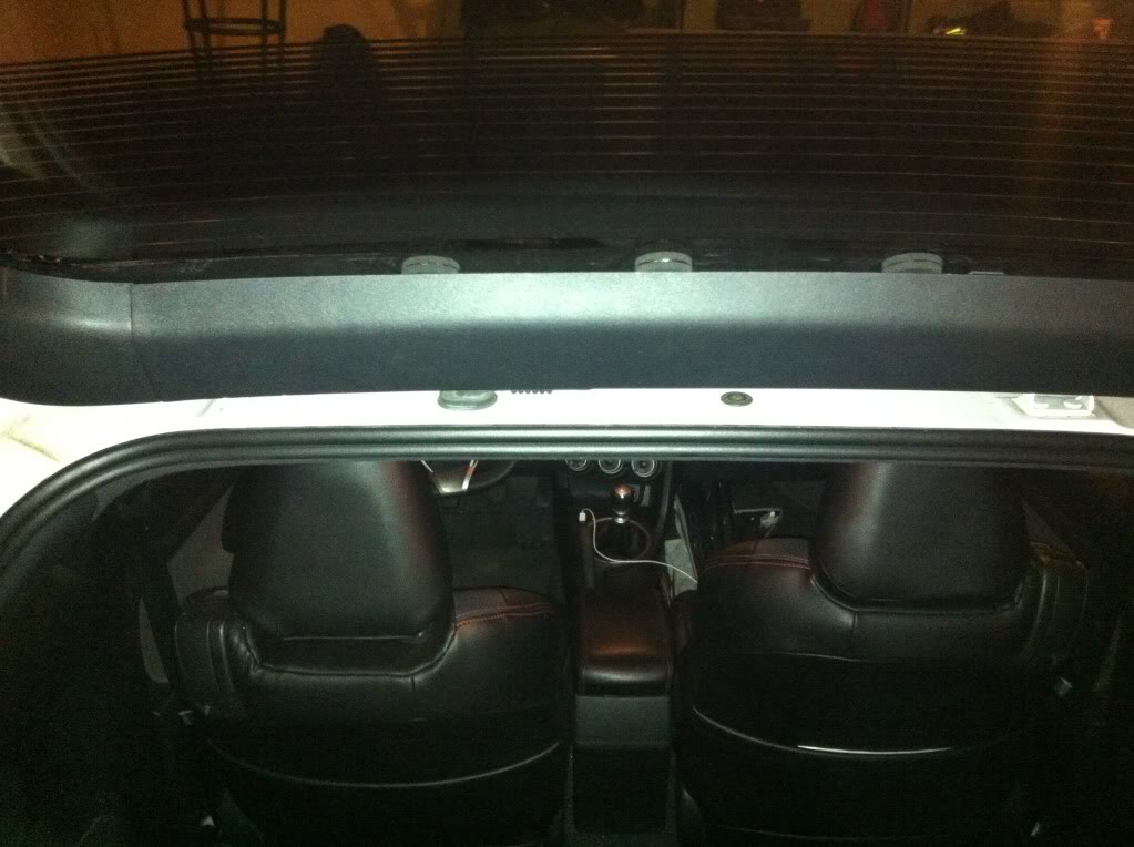

Ok... So, if anyone else has issues with a persistent metallic rattle from the rear hatch: I located the source as the top of the hatch, specifically where the glass is secured to the hatch frame. I found that squeezing my finger in te little gap would quiet it, so I put several rubber spacers in there. It may not be a solution to every hatch rattle problem, but it seems (knock on wood) to have solved mine.
