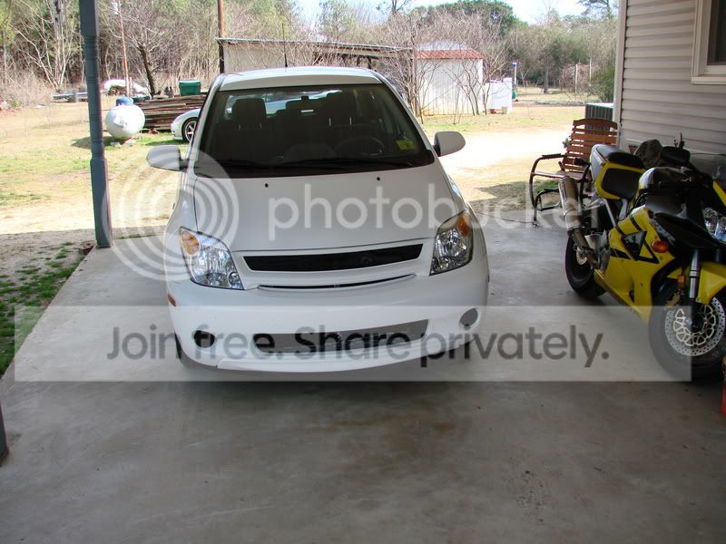

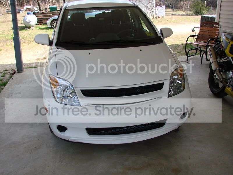

i got around to installing the grill, the color matches pretty good, just sucks being sick and trying to install parts when its 36 outside.

Man... after seeing that grille on your car, it makes me want one.
Shame it won't fit the '06 without modification.

Whats that small front lip? NEVER seen that before.
Old Feb 3, 2007 | 07:14 PM
  #171
Narcolepsy123456's Avatar
Posts: 217
The car is a 2006, i bought the 2005 bumper thinking the version b lip would fit it since the year models have the same design as the 2005 IST. my mistake was the reinforcement caused the bumper to protrude too far forward. I will correct this by purchasing the JDM bumper and reinforcement, which will make the lip fit the curvature of the bumper better.
The small lip you are noticing is found on every 2005 xA, since I had to paint the bumper when I bought it to replace the bumper that was destroyed by the dog, I went ahead and painted the whole thing.
from what i could see of my grill (2006) now working with the 2005 bumper, it appears that the lines where the bumper/grill meet are off, so if you want to upgrade to the sport grill, you will have to trim some off the bottom to get it to fit right, any good body shop can make this happen and it will look great. there is a black peice covering a clip hole you will need to remove to do so though, took me about 20 minutes to figure out how it comes out.
