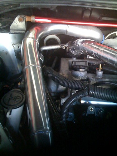

Old Aug 29, 2008 | 04:08 PM
  #108
vettereddie's Avatar
Posts: 2,476
From: Patuxent River, MD
Minus the welds, is that the stock routing configuration for the Greddy FMIC or did you need piping swapped or re-bent? I haven't seen the FMIC installed in porson yet.
Old Aug 29, 2008 | 04:29 PM
  #109
xa007xa's Avatar
Posts: 473
From: Chicago, IL
I chopped up the piping to make it work. then had it welded.
Old Aug 29, 2008 | 06:00 PM
  #110
Posts: 2,476
Any particular reason you thermal wrapped the front engine harness? Looks like the friggin' space shuttle in there now.

  #111
xa007xa's Avatar
Posts: 473
From: Chicago, IL
gets very hot. don't need to melt wires.
Space shuttle FTW!! I am sure it gets hot enough around there now to justify it, and he did it very clean/complete
