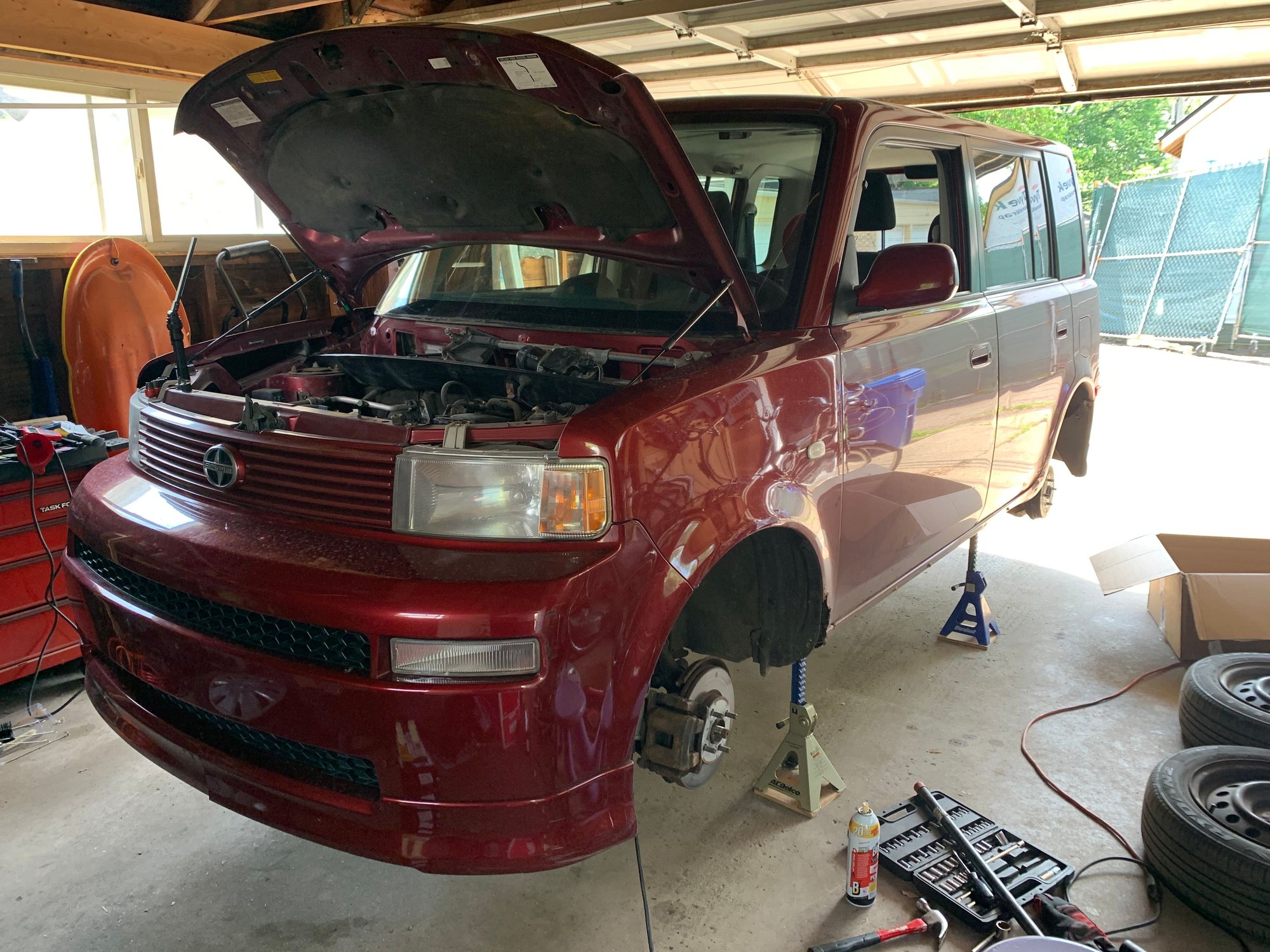

Well done. Where did you have the jack stands located? I was worried if I unbolted the subframe, the car body would move around.

I placed the entire car on stands on the four corners.
Floor jack 1 with wood block to raise the motor.
Floor jack 2 placed below the center of the subframe. I put an extra stand on each side of the subframe as safety but that turned not to be an issue.
the biggest challenge was to line it all up together where the mount through bolt went through straight. Took quite some moving the engine up and down.
I also had to bend one of the power steering lines a bit to create space for the through pin / bolt.
FYI I did not need to detach the exhaust.
hope this helps.
