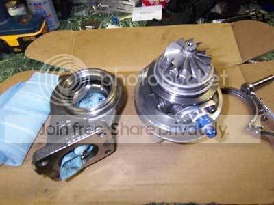

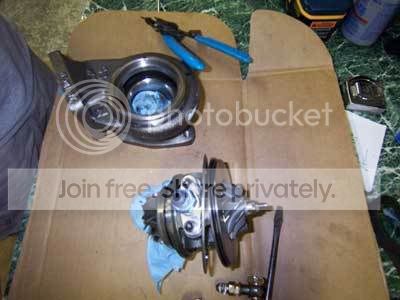

Like I said in the previous post, we took the turbo out and reclocked it:
Then we figured out why it wasn't working! It had some fleshy looking thing stuck in the compressor side... sort of resembled a... hmm...
But Josh cleaned it out...

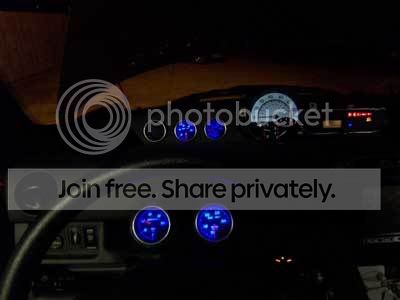

Last night I finished wiring in all of my gauges except my A/F (yeah.. the one I really need..)
(From left to right) On the dash is A/F, Oil Pressure, Boost and on the column is Fuel Pressure and Water Temp.

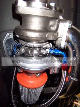

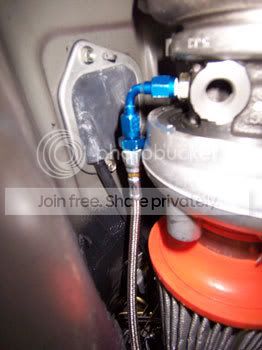

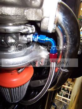

I never made it to the exhaust shop. The next time I started her up oil was coming out both ends again like nobody's business. So, I shortened and rerouted the oil return line from the turbo to the pump. (no pics)
I also added a ,060 oil restrictor to the filter sandwich adapter side of the oil feed line. (no pics) Before you start commenting on this arrangement, read on...
The restrictor I ordered didn't fit the turbo side of my setup. I hated to waste the money so I slapped it on the front end. That will keep more pressure in the block than in the oil feed line. Now, it will build up substantially more pressure than I need in the feed line, so I also ordered a .035 restrictor for the turbo side. That's all this thing will need. So, yes. I'm running two. One on each end, the turbo side being smaller. (I know... the turbo side is all I really need and should take the front one off. If I'm not getting enough to the turbo or there are any problems I will, but for starters I'm using both. )
The problem that came up was the restrictor for the turbo side fit where the banjo bolt used to be, but was a -3an on the other side. My feed line is -4an and was NOT going to bend enough to attach anyway being that close to the body of the car.

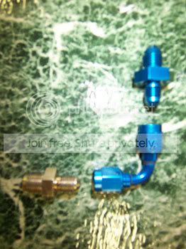

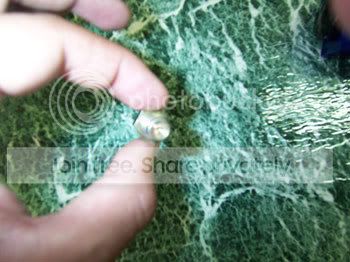

The .035 restrictor:
So, off to ordering I go again. I get a -3an 90 elbow from Earls and a -3 to -4 reducer.
Nice and snug

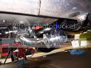

(Here's a pic of the return just because I was under there)
(And both

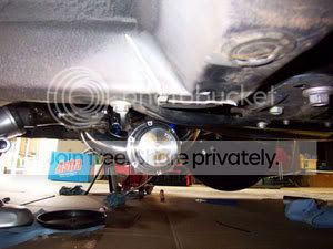

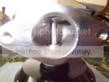

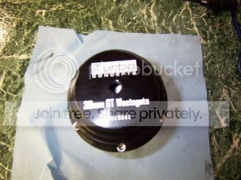

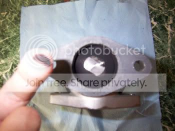

After setting this up, I went to swap out a part. Time to install the new Tial 38mm Wastegate where the Turbo Concepts GT was.
When I pulled the GT off, this is what greeted me:
I went ahead and installed the new one:
(Side note: obviously I did this before the oil line based on the pics... nothing was wrong to make me undo them again. )

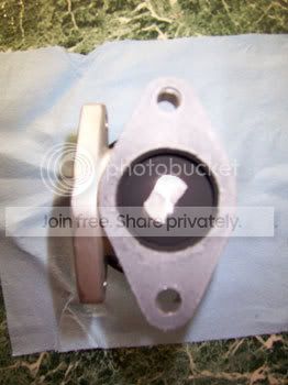

So... it's running rich. But, is it just because I'm running larger injectors on stock plugs, ecu, n/a etc.? Did it happen when I wasn't in boost all those first times we fired it up? Does it just do this anyway? .... So I looked inside. And found....
nothing.
Clean as it came. So, either
A: I never hit enough boost because of the issues to open this thing.
B: My vacuum wasn't working correctly.
C: When it did open it just blew everything out and didn't leave any residue.
I ruled C out.

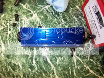

It's probably A, but just in case I made a decision to reroute my vacuum lines a more professional way. I got a vacuum manifold block to run off the brake booster.
I will be installing this and in the process cleaning up the lines I cut to run vacuum the first time as I install the catch-can. I'm taking a week off for paternity leave when Kaylee arrives so I'm going to spend some of the time in the garage. I'll update again when I can.

nothing.
I ruled C out.
