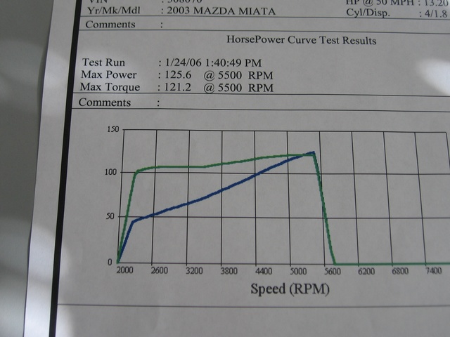

Only question I have, and a SRT tuner have is what is up with the power band on the Dyno? it shows 0 horsepower up to about 3500RPMs. Just looked a lil odd to us.

The mustang dyno has a set start and stop MPH. Which causes it to not record until a particular speed is reached. I forget what we had it set at.. This differs from the Dynojet, where you just push a button to start the run.
Here's an example of a end speed set too low.
http://gallery.wewt.net/albums/dyno/IMG_1231.sized.jpg

Good stuff, thanks for the quick reply. I'd do pistons and rods just to besafe, and to crank up the boost a lil :D
