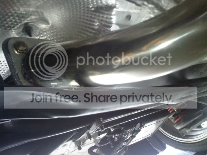

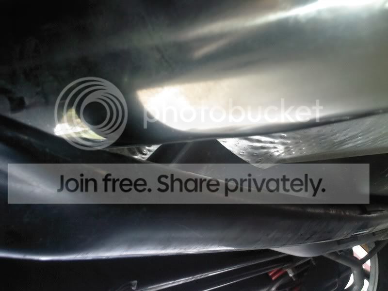

you can see on this pic how close the piping is to that underbrace bar. its ok when u drive for a bit but once the exhuast gets hot and the hanger gets softer, it starts to rattle like ****

hmmm...remedy could be:
to somehow shorten the rubber piece on the hanger
put a dent in the pipe there so that it doesnt rattle...
line affected area with something soft? that wouldnt catch on fire :p
____...
oh you could get some 'steel strap' and wrap it around and help pull it up by attaching it to that visible heat shield screw in pic 1....
