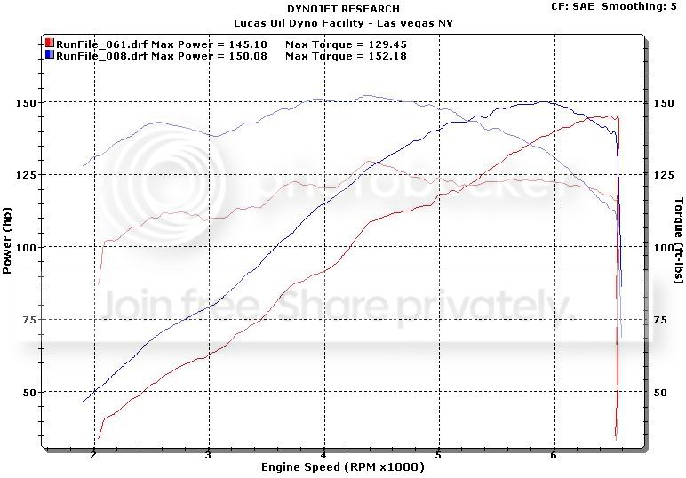

More new info from Dynatek!! Richard is asking me to post the graphs as he is having problems uploading pics.
From Richard Holdener:
This is a comparison between the modified Xd motor (145 wheel hp) and a stock 2008 Xb (150 wheel hp). Despite the similar peak power numbers, the larger 2.4L offers significantly more average power production through the rev range until the peak engine speed. The extra 30 lb-ft of torque offered by the Xb would be difficult to offset by the lighter weight of the Xd. I have never raced these two cars side by side, but it looks like the heavier Xb would still hold the advantage in a drag race.

Dyno graph is all that should matter at this point. Picture of a funky prototype will help nothing in my decision cause it will look nothing like it.

good info! even with 30lbs more tq than the xD, it still weighs about 400lbs more... i still think the xD would take the xB. either way, im still commited!
btw, edmunds.com lists the stock 0-60mph for the xB at 8.6sec (AT), stock xD 8.4sec (MT)... with the dynatek intake mani, the xD should still take a stock xB even if its a manual.
