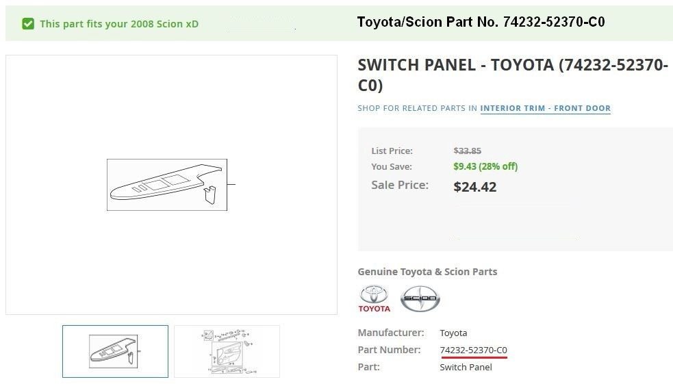

I've been looking for a photo or drawing of the underside of the bezel so that I can better aim the screwdriver, but I haven't found such a photo/drawing so far.
If anyone can provide a URL to such a drawing or Vid, I would be most grateful.

The Official Toyota Parts List show only a small drawing of the part w/o the underside. It appears there is a release clip towards the forward area.
There are no 2008 xD Switch Cover Removal video unless you want to Create your own. Refer to the Lexus Rx300 video as a hint/tip.
