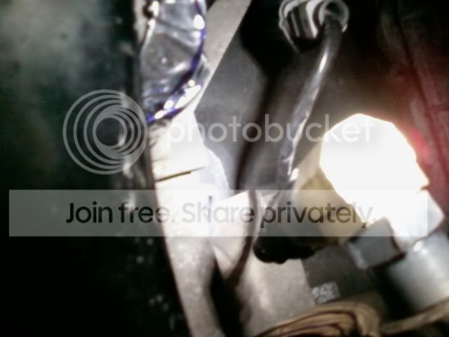

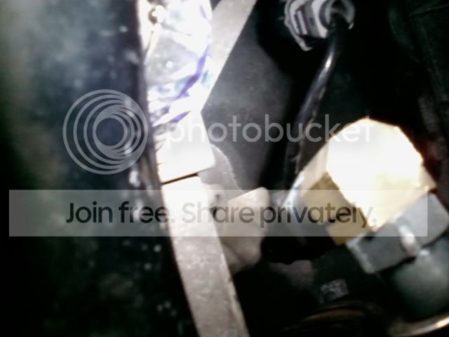

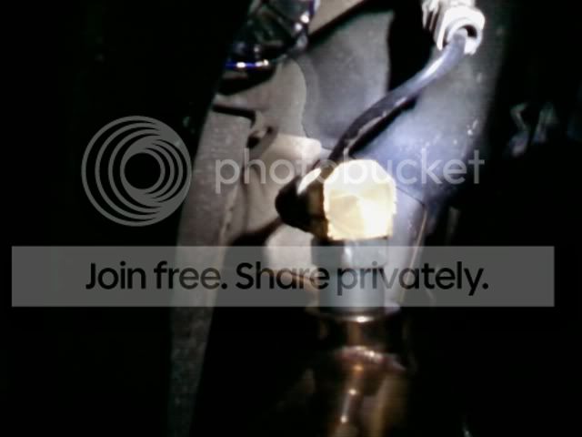

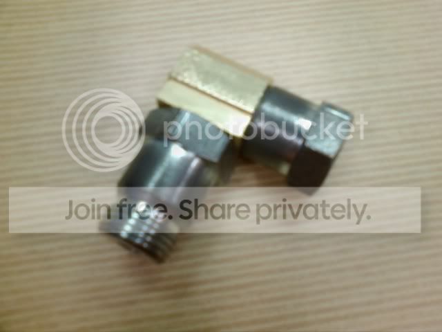

Here is a great idea for any of you having troubles with O2 sensors. After i got th invidia s-pipe my O2 bung was just a hair too low for the sensor and anti-foulers to fit. So i went to Home depot and got a gas line "street" style elbow connector. (Pic 1) I had to do some fab work to make it fit, but the end product is perfect. I had to drill the female end out with a 11/16 bit and a 18mm/6 tap and die kit. The problem i had was that the sensor and anti foulers stuck out too far that they hit the K-member??? and Rattled like a B!tch. Even so bad that it would work it's way out of the threads and jiggle loose. I tried to use Dynamat to kill the rattle but it didn't work at all. You can see the dynamat in the pics to get an idea of where it was hitting. All is nice and tight and quiet now. Still no CEL.
Pic 1

that is pretty crazy looking.....the invidia o2 bung is not located where the oem is??

Pretty damn close, but it may have something to do with the bigger pipe, 2.5" compared to 2.25". Or maybe they are hand built and can be slightly irregular when compared
