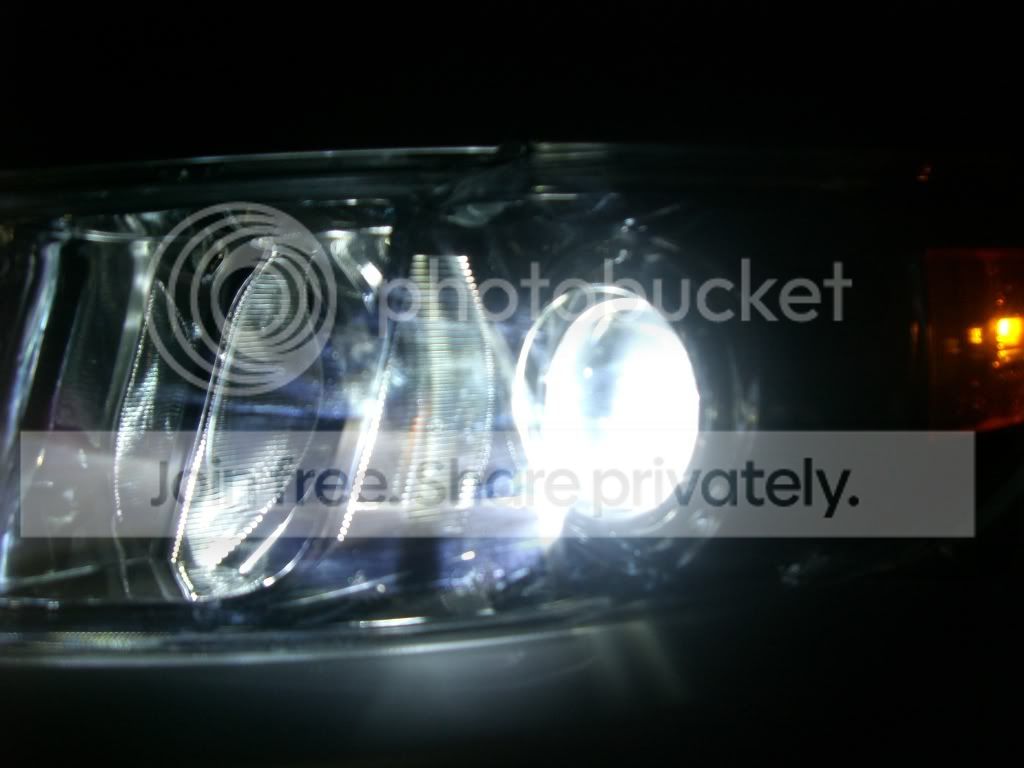

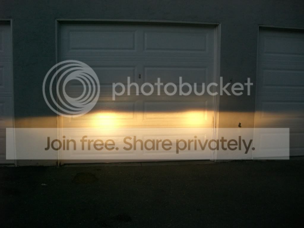

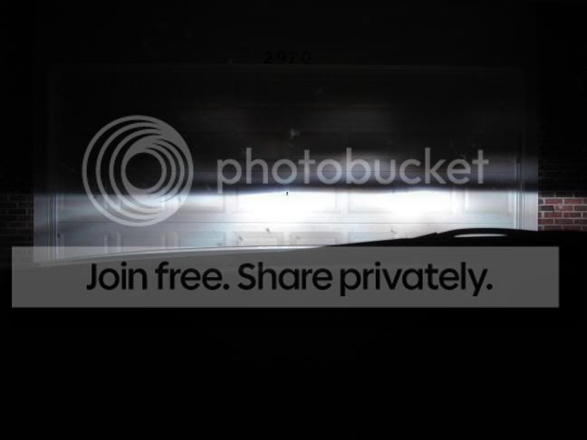

Pics of MobileHID 6000k compared to Stock on wife's 08 xB.
Stock.....
6000k HID

wooo hooo! very cool man. you'll be surprised at how driving with normal lights from here on out will feel like you're driving with your lights off.

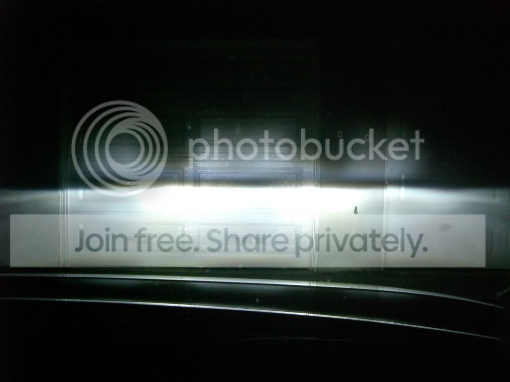

The light distribution pattern is just like mine. If you notice on the photo of the lights projecting on the garage, that above the horizontal light cutoff, that there are 3 regions of glare, 1 larger in the middle and a smaller region on both the left and right. I did some observations and the glare region shining to the left will be a problem to oncoming drivers. So using some black electrical tape, I masked off small portions of both headlights (I blocked the light from the right headlamp with a towel when doing the left headlamp and vice versa) to eliminate the left shining glare. Then I cut a 4" piece of tape for both headlamps to minimize the larger middle region of glare as seen on the garage door photos. This seem to reduce the problem significantly. I have taken some photos of this and hopefully will post them. It would be nice if the projector headlamps increased the intensity of the light more just below the cutoff, i.e. less light in the immediate foreground and more light at say 150 yards, however evenness of the light distribution is much better than any standard headlamp I've had.

bkirby, you are right about the washing out of the lights when driving with the 6000k's. I just like the hint of blue, but its still a lot brighter and better looking than the stock lights. I am going to test the glare out with my wife by driving in front and trying some on coming traffic scenerios. I was pretty close to the garage when taking the pictures, so I'm not sure exactly if that would have affected anything. Thanks for the pointers though. Can you post some pics up ASAP so I can see what you did to yours to reduce glare?

Above: Before attaching blacktape mask to headlamps. Notice glare above cutoff.

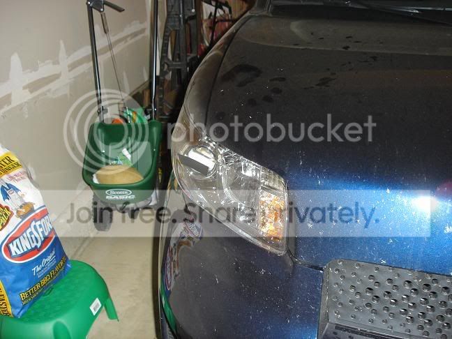

Above: Blacktape mask shown on lamps. This is done on both lamps. (Note: car was washed just after photo)

great pictures bkirby. I personally would rather keep those little spots above the cutoff line simply because it helps illuminate those things that are down the road and it can sometimes be difficult to see things above the cutoff line.
