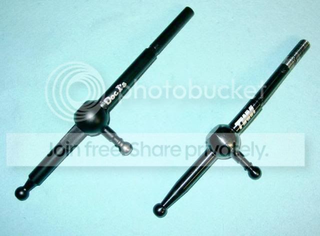

On the right, a TWM Stage 2.
On the left, an OEM shifter with the pivot ball knocked up the shaft about 8/10 of an inch and the top 1.5" inches of the shifter cut off.
Shifts are reduced by over 40%. The longest thow (1st to 2nd) is 2.1". The only shifter you'll ever need. And everyone has the part required to make it. So make it!

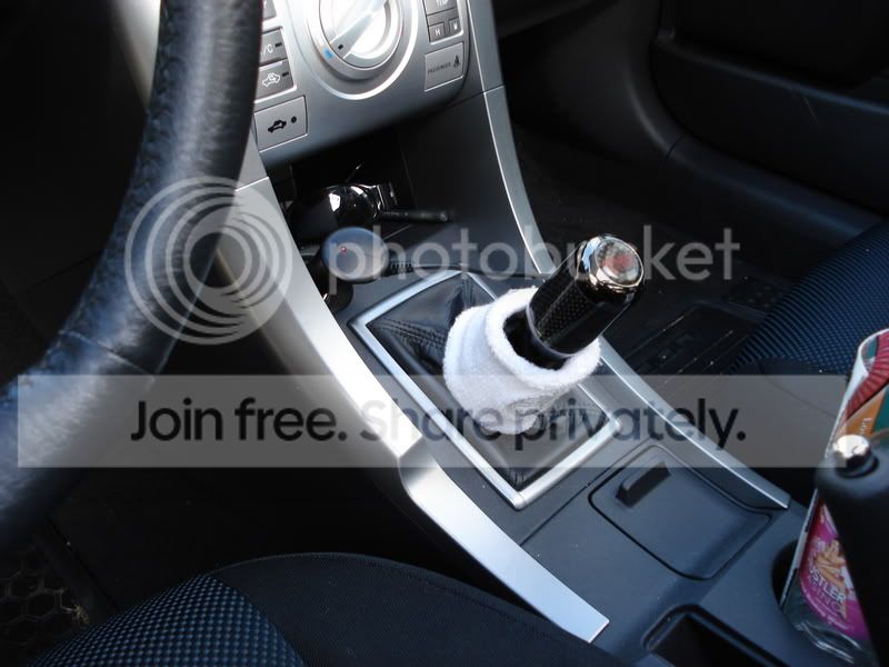

^^^yea man i just installed mine today, i love it, but it takes awhile to get used to...
some pics

What Short shifter is that? The pivot seems to have moved about .5". I think mine was moved around 1.5". I should have taken pictures. Damnit.

It's one of mine. Standardized GearSwitcher throw reduction (50%) and height reduction (2"). ALaS, yours is a specialty piece-- I'll likely not make another like it.

which shifter is that?
