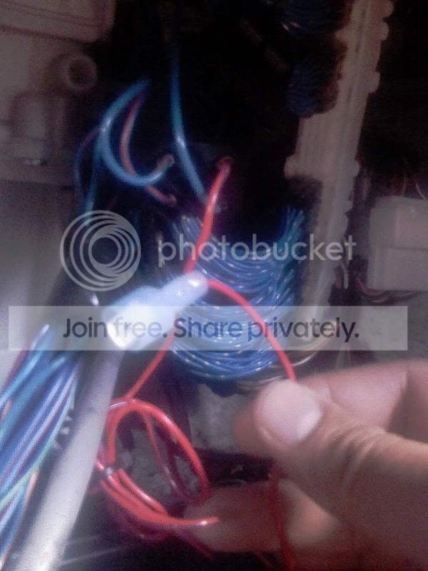

now here's what I found on my relay,
the red wire wasnt connected to anything, its supposed to be tapped to 12v constant on power! i've been running low voltage on my hydra the whole time.. anybody knows a good place to tap this?
props to awesome hydra customer support

Originally Posted by ippskidder
I just checked mine. I was worried there for a second, lol.
The wires coming off of my relay, are actually already wired into the harness, for the appropriate 12v constant and ground.
*phew*
From what the HydraEMS team told me, the harness didn't provide enough power, so they had that wire to be put direct to the battery (or as best you can).

Old Oct 19, 2008 | 05:27 PM
  #372
ippskidder's Avatar
1UP Crew
Posts: 6,138
Ok another question... If the voltage is low, what kinda problems will it cause?
