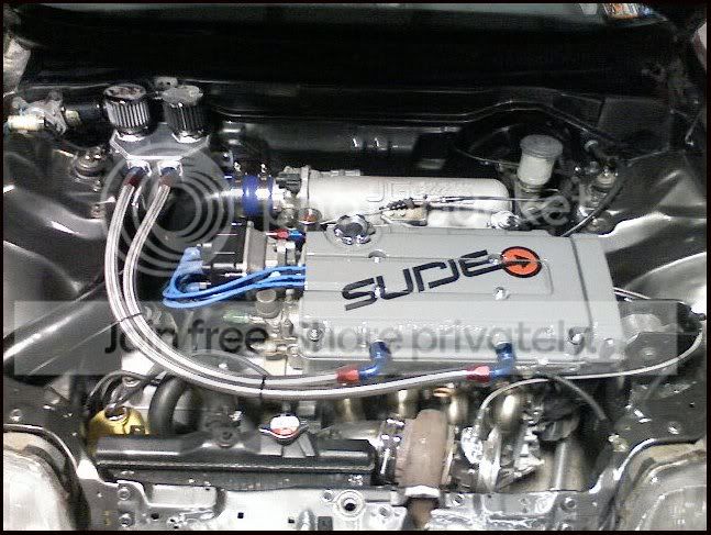

how are you guys handling blow by and the small breather tube that comes out the drivers side of the valve cover. just leaving it open?, putting a filter on it?, etc etc... awesome work so far BTW

From: TN
^^Catch can is what a lot of people run.
i know.. but typically you've got 2 ports on a catch can.. inlet from the VC and outlet... now are they running an endyne or moroso style can with a breather filter on top with a single line dumping gases though the top filter.... or are they running another style can that runs from the vc to the can and from the can it has to connect to some place else.. were does that extra line connect to... dumping burnt gases or possible oil back into the turbo would seem a tad blah to do...
Two port catch cans are usually routed back into the intake that is connected to the turbo. It's a catch can, so it "catches" the oil, and sends clean air back into the intake (if you have it routed there). Otherwise they let the other port vent to atmosphere as well.
thats what im asking.. if you vent to atmosphere your probably going to get oil coming out of it... this is why i was asking about endyne / moroso style catch cans as they alow you to vent to atmosphere while still catching oil and being able to drain oil.. here is a picture of what im talking about and probably a setup im going to use.
note this catch can has dual filters.. but one is all most of us need. im still debating on wether to ad an extra fitting for more venting and releasing as much crank case pressure and VC pressure as possible... but this is all theory also.. but works welll on hondas and nissans and other toyos... so i might follow the same path.
No, you wouldn't. oil is a liquid.....it will fall in to the catch can. Clean air would come out the other port vented or not.
no travis im saying if the fitting on the VC has no breather on it and is just vented like the pics on pg 1.. oil is going to come out... i know because ive seen it happen to a few tc's that have nothing on that breather tube that pops out the vc... get it now?

From: TN
Yeah I got you. That's the way mine is right now. I have a tube on it to lead down through the bay so oil can drip down. Until I get a catch can that is.

From: Motor City
I had my VC vent open for awhile and I did have one drop of oil come out. There a block plate built into the inside of the VC preventing oil to blow out. Oil does however come out of the PCV vavle that connects to the intake manifold.

i should just start a thread on this and not jack the OP's thread..
im trying to see what ppl are doing on various setups for this... wether to add addition venting like the pic above and route lines to a catch can which will drain back into the block or oil pan.

From: TN
^^that's what I was talking about. The PCV. VC has nothing coming out of it.
