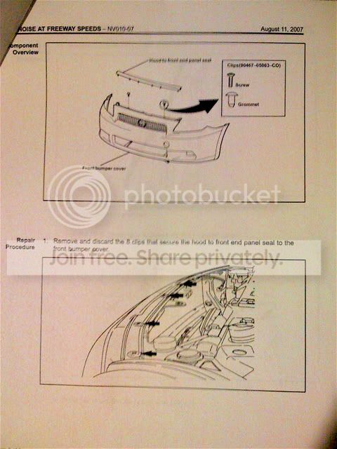

anyone have pictures of what the dealer does after they do the TSB?

pictures of what the dealer installed? what the clips look like what they changed to make the noise go away.

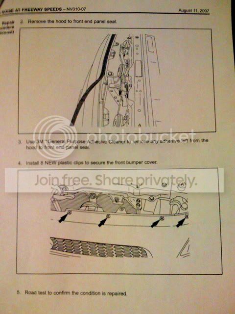

There's really not much to see, they basically removed the noisy hood seal.

so they dealer fix is the same as the fix mentioned in this post? i already removed the rubber strip and it made the noise go away, but im just trying to see if i should have the dealer "fix" it so i can put that reubber seal back.

Had mine fixed, nd the noise is completly gone. Dealer fix is the same as the fix shown in he begining of the post. not worth going to the dealer as it takes then hours to do it when you can do it yourself in 10 min.
