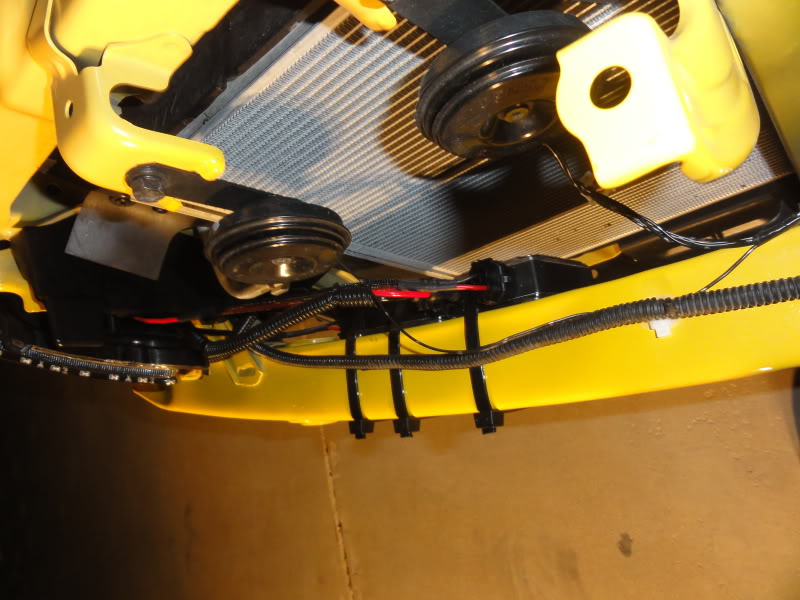

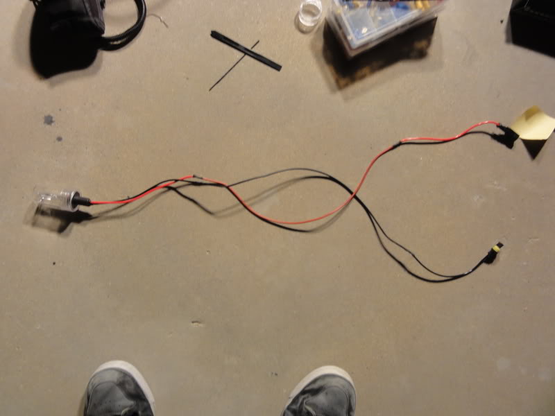

So the new HIDs are in, like i said before i wanted to mount them to the bumper and hide them, out of site and out of mind. when i started to mock it all up and make sure the cable would reach well they didnt the cable from the light harness to the ballast was sufficient length it was from the ballast back to the head light that fell short. So it was either abandon the bumper mount and find some where else or be really daring and cut the wires, solder and make them longer. but this would involve voiding the warranty of my brand new HIDs and possibly killing them in the process so i went with the crazy stupid choice and cut the cables and extended them to the length i needed. Pretty simple, cut solder shrink wrap and then stuff the wires in split loom so they blend in with the rest of the stock wiring. The ballasts are mounted with double sided tape and 20" industrial grade zip-ties, they are not going anywhere.
here is the new extended light harness

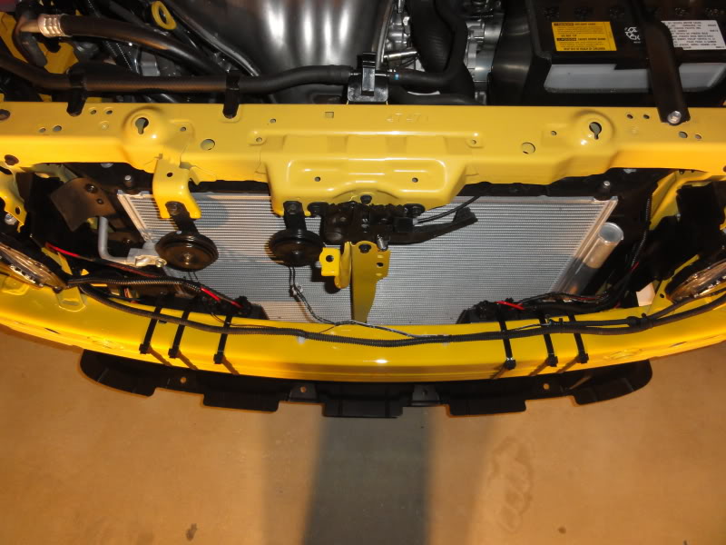

The ballasts all mounted behind the bumper

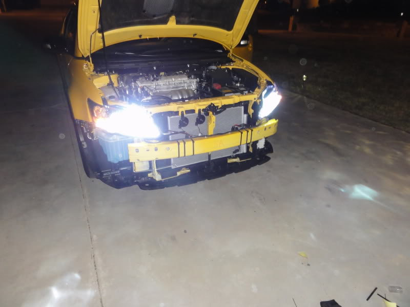

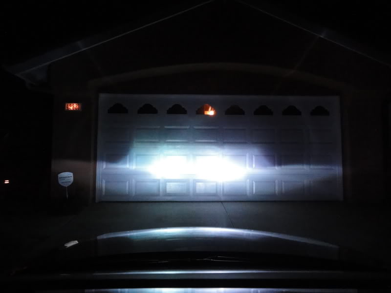

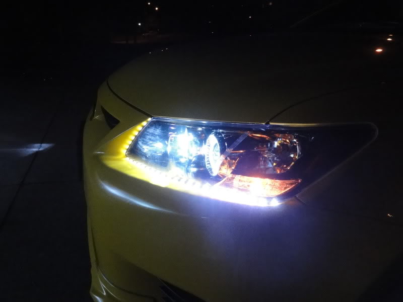

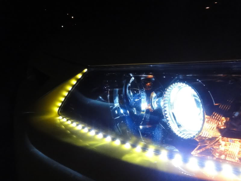

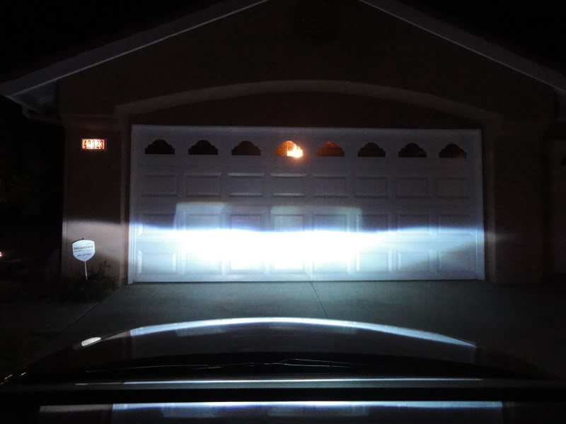

I went and took some better pictures of the new HIDS. (These are the Meng Motorsports 6000k 35 watt. for those who didn't read the previous posts)
Low beam
High and Low beam
