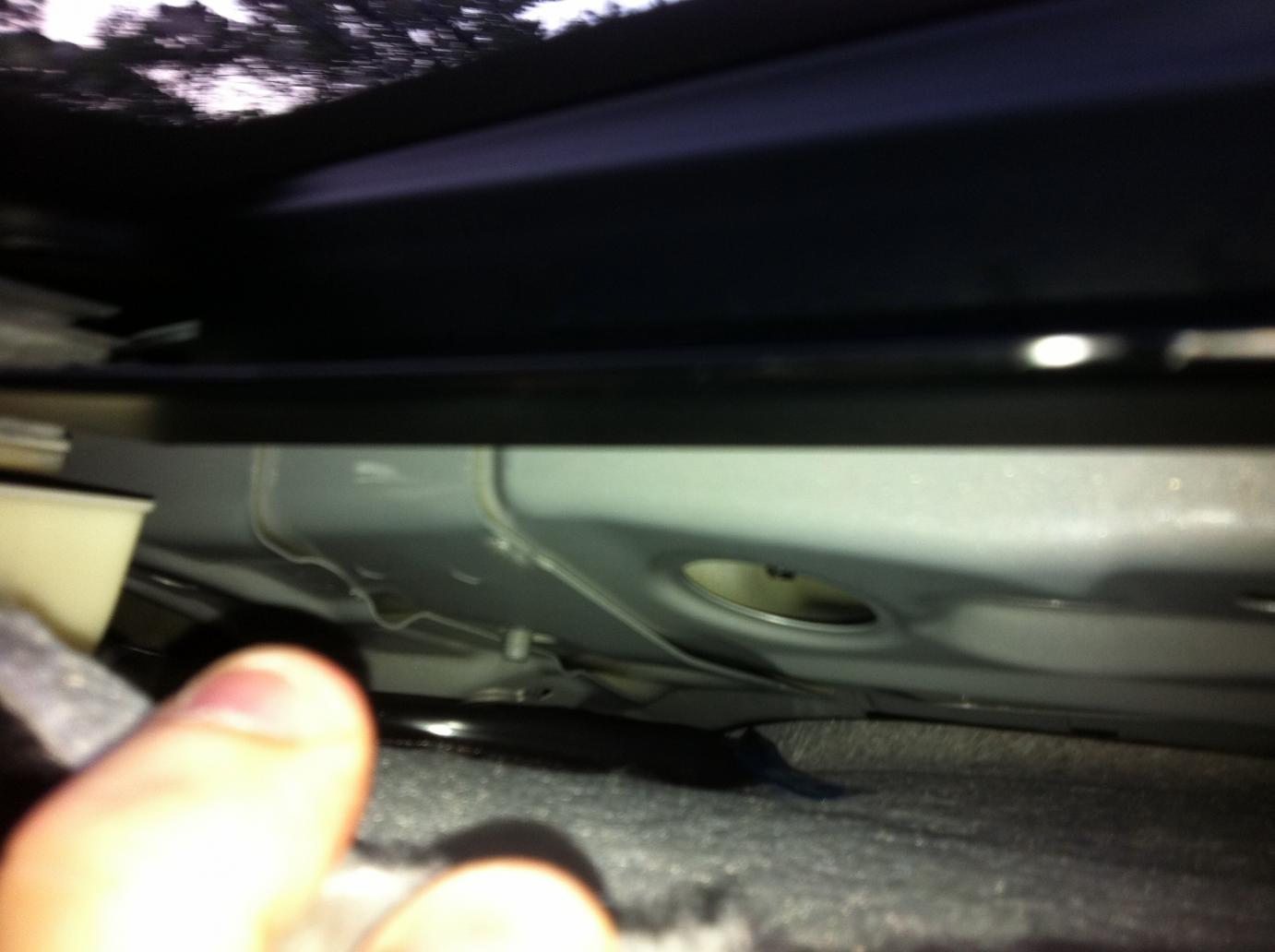

I've found the noise. While having my wife drive the car I sat in the back, on the passengers side. Used my ear to narrow down the area. Pulled the cloth gasket forward to separate the head liner, and found it. The noise got louder when I pulled down the head liner. Put my ear up to the area to confirm. Shoved my hand up there and put pressure on the roof metal and noise went away. See pictures. This area is located behind the rear seat sun roof, on passenger side.

Yes layed 2 papers towels down onto the head liner below metal (___ seen in pictures) and sprayed liberally with WD40. Noise has not come back. I left the doubled up paper towels up in the area, and sealed it back up, by pushing the cloth gasket/ring back into place.

the 3rd and 4th pictures above show the metal and head liner separated. This is where I laid some paper towels and sprayed WD40 with one of those red straw things attached to it, to direct the flow up onto the metal creaking area... hope this helps....
