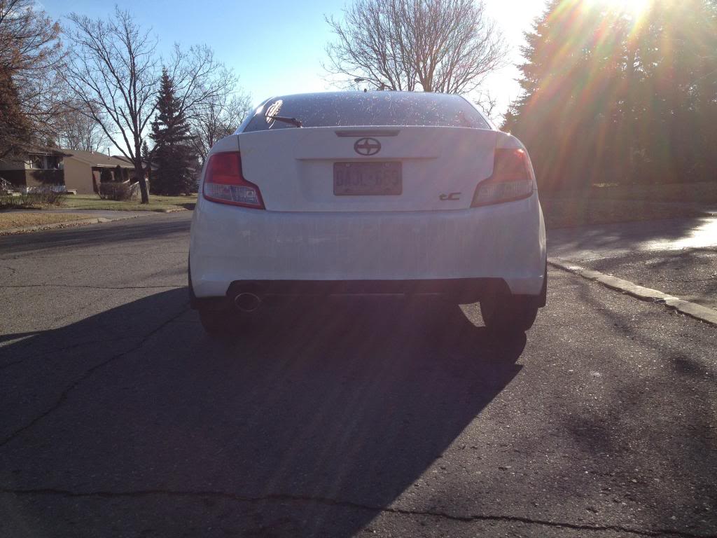

D-Thissen, do you have pics of the exhaust installed?
Old Nov 29, 2013 | 08:49 PM
  #131
D_Thissen's Avatar
Joined: Sep 2011
Posts: 132
From: Whitby/Thunder Bay Ontario
Yup, here ya go!
Dan
