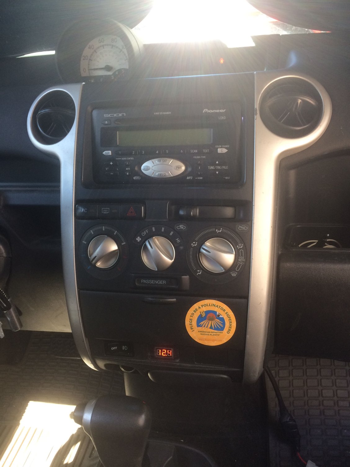

I have an ELM Bluetooth OBDII unit and Torque App on my phone to do all this with but yes...no oil pressure reading available on it either.
I am considering cutting 2 holes in dash next to Speedo and adding oil pressure/water temp gauges - 52mm.
Volts I get from the Dual USB charging port that replaced my cig lighter 12v and it has volt readout between the USB ports.

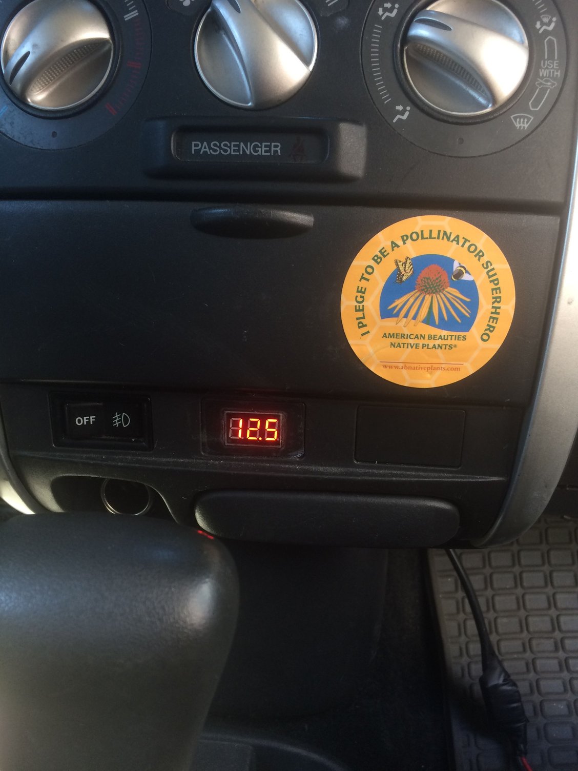

Hi, I like to have a way of seeing the situation with the car measurements. In live time is the best. Looks like Ultragauge Blue will do just that for an old model. This Ultragauge can be use also as a radio, for digital TV stations, and CD? Do the Space X have something similar? In my Scion xB 2004, I had install just the Voltage gauge (for $1.49). Will work from 7.5 Volt to 35 Volt DC like a voltmeter.
Here is in red color the car voltmeter. Will not take actions in case of emergency It is just an observant.
Here is the Voltmeter. in the picture. In parking with engine OFF. In driving times, displays 12.6 V to 14.5 Volts. Usually more 13.7 Volts (RMS).

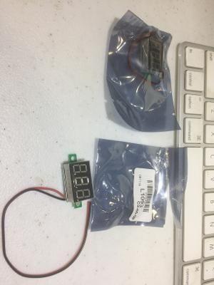

@mrmox The voltmeter is made in Elephant Kok Tong Village, Longgang District, China. And yes, the price was with shipping. I am little embarrassed because was made with slave labor.
Here is how the Voltmeter is delivered in antistatic package. Please see the fabrication code on the plastic bag.

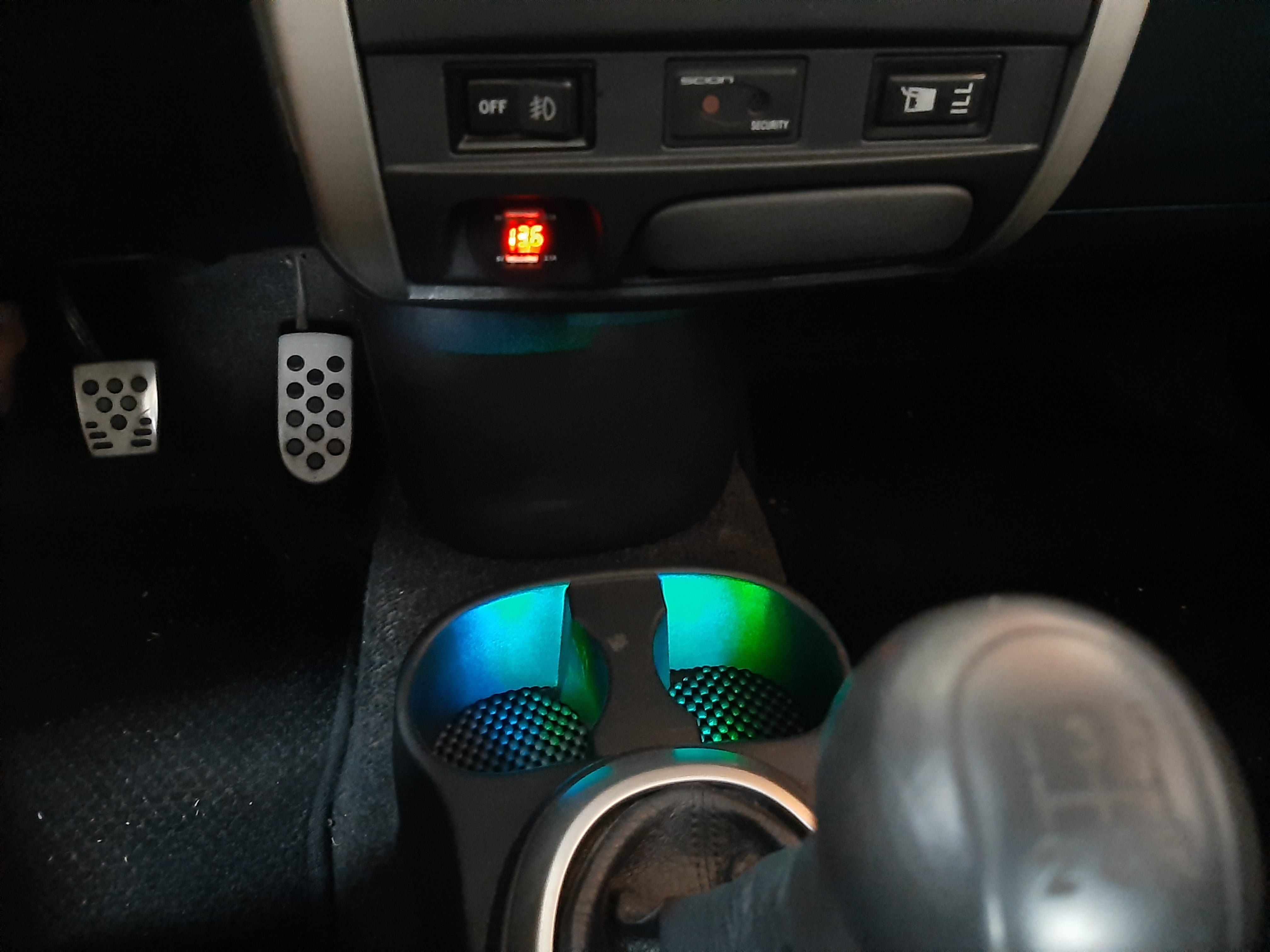

I added for my daughter an UNSWITCHED power take off (cigarette lighter socket) running into the back seat area. This is for the camping scenario to be able to use accessories without the key in the ignition. I feel the need for her to have a way to notice if she is depleting the battery dangerously, and while I love the UltraGauge and Android Head Unit, they have to boot and Blue Tooth Connect just to read the voltage which is too much trouble.
I had a plug-in-the-lighter device but it was junk reading more than a volt too low vs. a real volt meter. And, even the lighter socke needs the key in as you know. That is why I thought of copying your solution but to a hot wire and adding a switch.
Until then though I bought this item and it has a reasonable voltmeter in it. I think it will serve the purpose.
