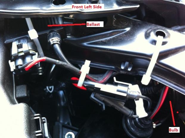

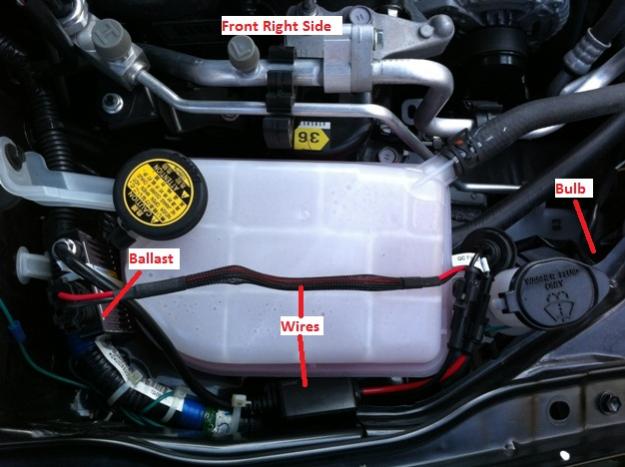

Attached are pics of where I put my ballasts. My setup is somewhat of a temporary permanent setup since it's only secured with tie wraps instead of 2-sided tape.
The first one is on the front right side.
The bulb is hidden from the pic but right in front of the windshield washer fluid. The ballast and one side of wires are secured to the huge black cable. One wires could not be secured because it wasn't long enough to pass around the side of the reservoir
The second one is on the front left side.
The ballast is secured to the frame of the car. The tie wrap runs right around the frame and the ballast. Another tie wrap (right one) is holding some wires under the frame section. The middle wrap is just holding the wires together and not secured to any part of the car.
My ballasts were slim enough to fit up on the side frame of the car but I didn't want to put 2 sided tape so I ended up with the attached setup.
I have the DDMTuning 35W 6000k Slim ones. No problems with broadcast radio either! They are digital ballasts. No relays were needed in my setup everything worked first try. I'll be wrapping the connectors with electrical tape later.
