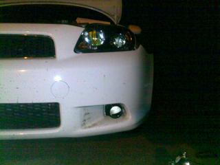

I don't run 3000K bulbs yet...but I have modded my 08 OEM projectors to be in-headlight fogs / extra intensity to my retros (which are e46 modded lens projectors 5000K replacing my high beams), so yes they are set to run 3000K, but right now they run 4300K. Just don't feel like buying 3000K HID bulbs yet..or short on money cuz i want a whole new kit.
It's either that route, or get mini projectors modded into the actual APT / VRD fogs I have and just keep the plastic lens down there to project it from debri. Either way, I will run 3000K fogs prior to winter settling in Wisconsin. So all-in-all ; I'll run my quad retro with even more projectors in the fog area to shine more yellow for foreground like how fogs should function.

Here is the quad setup...
And when I was test fitting the OEM projector into the fog area... didn't fit without cutting the mounting area in the bumper for the fogs lol (I had already shaved off quite a bit on the oem projector as well..) So i put them back into the 08-10 headlights I had.
