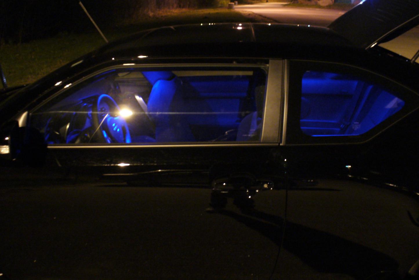

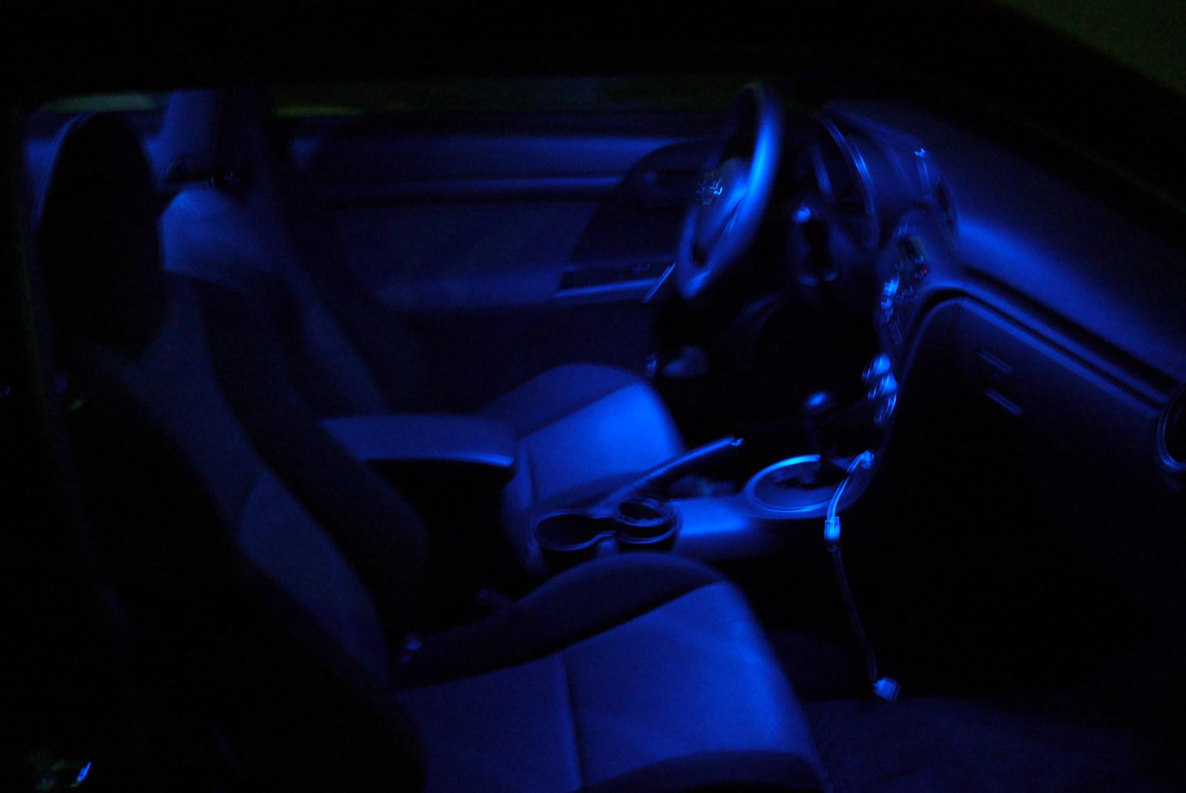

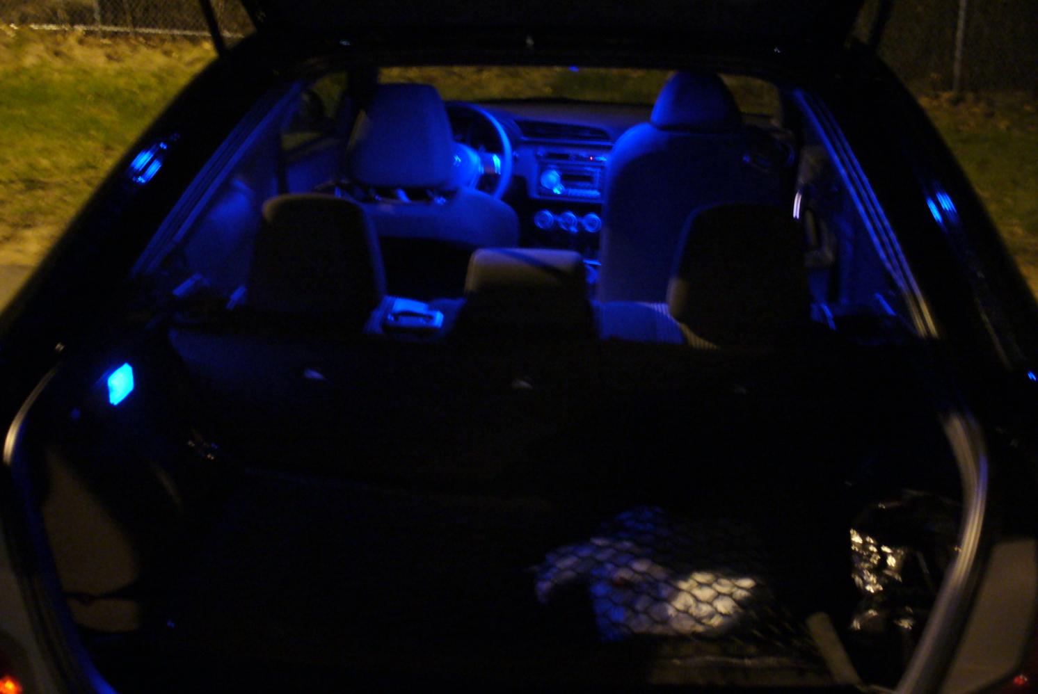

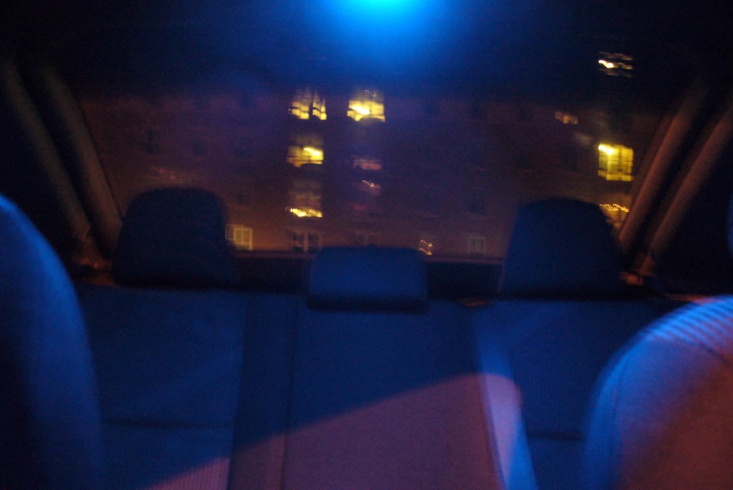

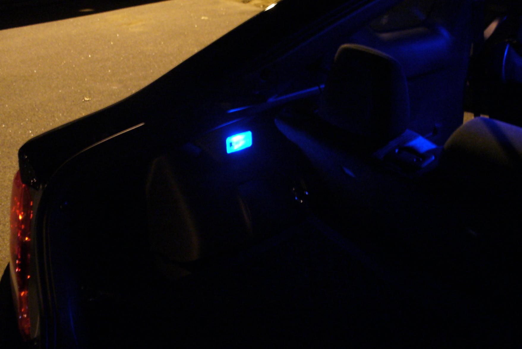

[QUOTE=rAaR;3788974]12 fits, i just switched mine out with red 12-led and they fit just fine. i'll add pics when it gets dark
:edit:
photos (sorry phone camera :?)
front dome (sorry bout reflection off rearview, w-led12)
