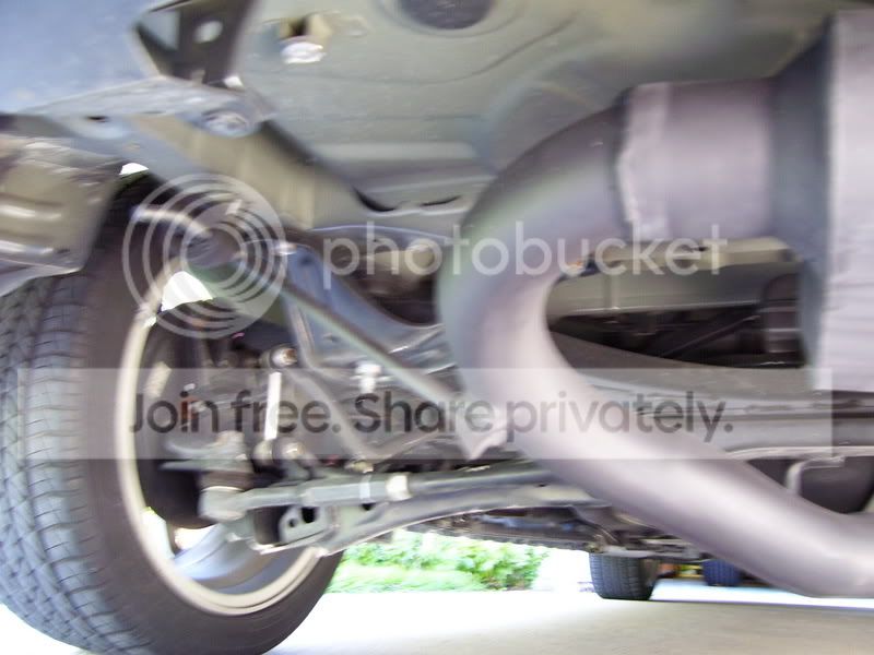

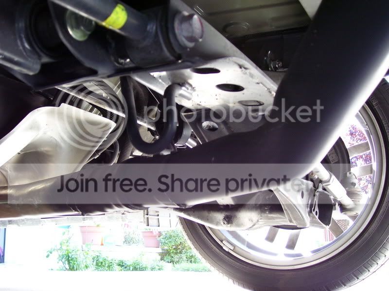

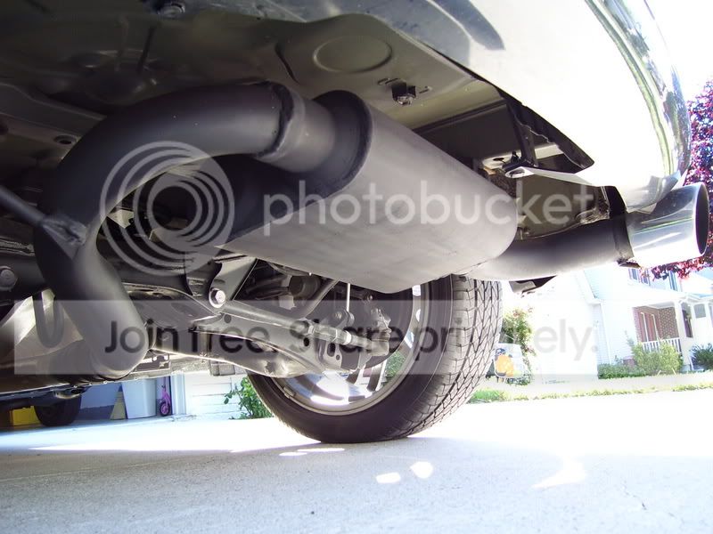

I ended up get the rear cut off today and got a 40 series flowmaster on. Sounds like a mean outboard motor now..........haha............not really a pinging sound but more of a pop now but it flows with the muffler sound I'll get a video up either tomorrow or day after.
Old Oct 29, 2006 | 01:56 AM
  #637
Bsmntcuts's Avatar
Posts: 292
Videos and pics of piping please...
Old Oct 29, 2006 | 01:57 AM
  #638
Bsmntcuts's Avatar
Posts: 292
Cost?
Old Oct 29, 2006 | 02:15 PM
  #639
web's Avatar
web
Posts: 2,338
From: Central Maryland
75 for the muffler and 50 for the install.
This is on a cold start and it's about 50 degrees outside. My speaker is really sensative so I'll try to get some better video later today after driving for a bit. Interior resonance is a bit more but not bad. I have the whole car deadened so it's not bad. The high pitch rattle isn't there but now it a high end WOT growl sound. I have a feeling it's due to our header and not enough of a resonator, but it's more of a sound I like since I had a truck before this. It's a nice, SRT-4ish growl on the highway and on downshifting. Definately a totally different sound than the Draxas rear. I love it . I might get another resonator added in, 12-14 inch, maybe near the gas tank area to help out but not sure. It's much better than it was.
